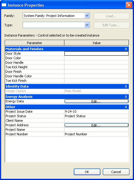

Does anyone know how to set the parameters inside "Project Information" to appear in a set order?
We want to enter our colours here but they need to be in a set order ie. Floor, walls, roof, windows, doors etc. There will be 20 items in total.
I've tried several different ways but can't seem to work out of how it populates the list.
I've tried adding numbers to each parameter, Making them at different times etc. but nothing seems to work.
Any help would be greatly appreciated.

Sorry for the confusion.  I'm not talking about anything that actually shows up in drawings.  I have added a lot of parameters in the project information, and when you go to settings-->project information, they just aren't in a logical order.  For instance I have parameters of SED1-SED6, and in the project information there is SED1 followed by occupancy, and then something else, and then SED2...It probably sounds silly that I worry about things that don't have anything to do with the actual project or drawings.  I just want our template to be perfect.  Thanks for responding WWHub.

Yeah, that works ok if you are just creating your parameters, but say you are me and you have already made like 12 different parameters and each one has a long complicated equation that you don't want to have to retype. This naming thing won't work because the parameter has already been given it's order. I would have to delete it and recreate it using the described method then retype the whole equation. This wouldn't even be that bad if it were just one parameter, but like i said I have like a dozen.

That post also only applies to parameters in families, and won't work for the shared parameters that you add to Project Information.

What some peolple don't understand is that you can rename a parameter ...OLD ... then create the parameters in the right order ... and ctrl-c the old formula and ctrl-vinto the new parameter....
But that is out of the box thinking.
Project parameters are listed in alphabetical order.

I was not trying to attack your advice, and I am sorry if it came across that way.  I did find the link you posted helpful for normal families, and I have found all of your posts I have come across on the site to be informed and very helpful.  I know the limitations of the software are not your fault.  As best as I can figure out Project Parameters do not sort alphabetically, see the attached image, and I am puzzled at how Revit decides to sort things.

I'm having the same issue. I've added consultants and their contact information to our Project Information. I assumed it would display in alphabetical order. Could it be displayed in the order in which the parameters were created? I did a test parameter to see where it would land, and it is displayed at the bottom.

I have been doing some experimenting and I think the order, at least for shared parameters, is based on the order they were created in the shared parameter file.  So to fix my issue, I manually edited my shared parameter file and deleted the parameters I was having issue with, then from Revit I re-created the shared parameters in the order I wanted them listed in my project, then I added them to my project in the same order.  I haven't experimented enough to know for sure if it was the order I created them in the shared parameter file, or the order they were inserted into my project.  The sorting problem I was having earlier leads me to believe the former, but as I said, I can’t say that definitively yet.  I hope this helps.

Just doing some more testing and I stand corrected.  The order that parameters sort in the Project Information dialog is the order they are added to the project.  The order they are created in the shared parameter file has nothing to do with it.
