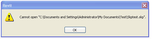

Sat, Jul 7, 2007 at 1:25:55 PM | Importing Sketchup into Revit
zanzibarbob
Joined: Wed, Aug 4, 2004
26 Posts
3 Stars: 1 Votes
I keep getting this error when I try to load a simple SKP test file either into an inplace mass family or a regular mass family.  I'm using the latest Skepchup and Revits builds.  Suggestions?

Wed, Mar 11, 2009 at 11:16:23 PM | Importing Sketchup into Revit
rierie
Joined: Thu, Feb 12, 2009
16 Posts
Hi, I've read the tutorial and several threads posted here regarding importing sketchup file into Revit, but I am still getting an error message that says, "cannot import ____(file name)___". The error message does not give me a reason why I cannot import. At first, I thought it's the file problem, but I cannot even seem to import a very simple .skp file either - even if it's just one rectangular box.
I also tried to export .skp file to .dwg or .dxf file then tried to import it into Revit. That does not work either.(I just get 2D import rather than 3D
I tried to follow the link for Suitability of Imported Geometry on this thread, but it's a dead link now.
It seems like W1ZYWIG (on another thread) had similar issues and he resolved it by cleaning up his computer... but I don't think my computer is infected with virus...
Any other thoughts? (I'm using SketchUP Pro7 and Revit Architecture 2009.)
Wed, Mar 18, 2009 at 12:02:26 PM | Importing Sketchup into Revit
ryder217
Joined: Thu, Jun 15, 2006
5 Posts
5 Stars: 3 Votes
I'm getting the exact same thing... and I'm at my wits end... In Revit's program folder there is an executable labeled SketchUpWrapper.exe, but I cannot run the file. Not sure if this has anything to do with it though.  Anybody's help would be greatly appreciated
Fri, Mar 20, 2009 at 1:17:25 AM | Importing Sketchup into Revit
rierie
16 Posts
For that particulr file, I ended up asking my friend who uses VectorWorks to import it directly from SketchUp, then export it to .dwg for me. then importing that particulr .dwg worked in Revit! Crazy work around, but it worked...
Try saving the sketchup file to version 3 too. it didn't work for me, but  that at least gave me a different error message.
Thu, Jul 23, 2009 at 12:49:58 PM | Importing Sketchup into Revit
Thread Post Kudo! #9
HOWELLS
Joined: Wed, Oct 1, 2008
1 Posts
If your are using 9 just make sure you save your sketchup file back to version 5 and I had no problem at all.

Fri, Nov 5, 2010 at 10:57:40 AM | Importing Sketchup into Revit
#14
AHouppert
Joined: Mon, Mar 8, 2010
1 Posts
THANK YOU! So much! I've been tryint to get my sketchup models to go into Revit for weeks. Saving the sketchup file as an old version (5 worked for me) did the trick. This make me very happy.
