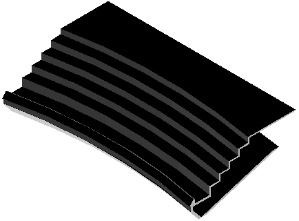

Made it! Thanks!
But theres a problem hehe
since it being a curved one the radius of the curve gets bigger from front to the back... hehehe
unlike on a stair where you can place a boundary for it..
hmmm
anyway thanks!

You could try making the stairs out floors.
