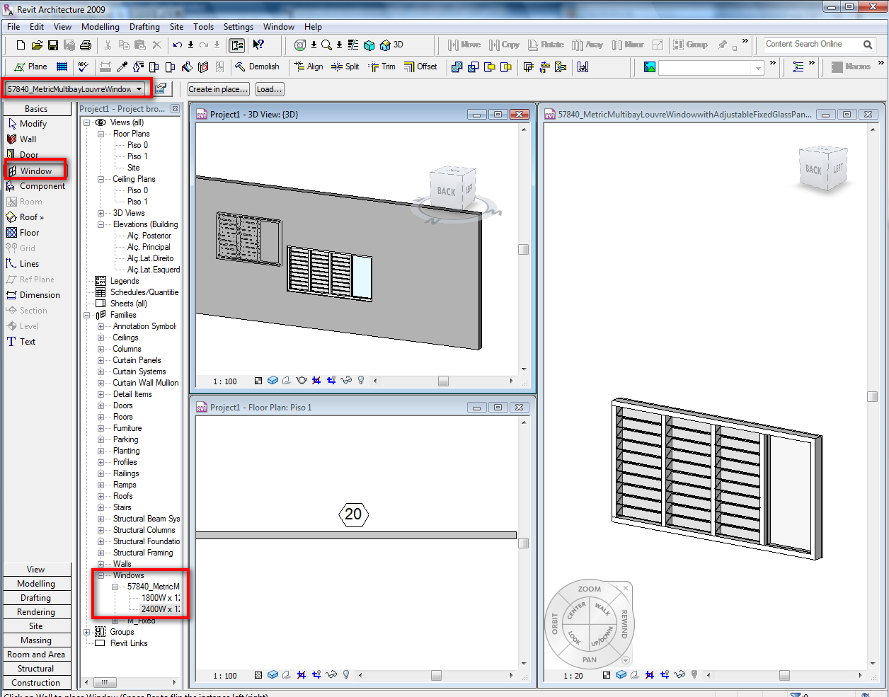

i have a problem loading the louver system component, which is attached to this message. when i load it into my project i dont see it on teh drop down componenet list. any idea how i can insert it, either into a curtain wall system or just sitting on top of a curtain wall system?

It's a "Window", if you edit that component and go to settings>Family Category and Parameters you can see it's in "Windows" category and in your project, project browser>Families>windows you can see that, just click in windows and select that, place in the wall.....

ok i see that its a window, and i was able to place it easily inside a basic generic wall. however, what if i am designing my own curtain wall/curtain grid system that has indvidual panels? usually, u can highlight a panel and then switch it from solid to glazed or vice versa. but it doesnt seem like u can put the louver system into the curtain wall. how can i do that?

To "insert" a "Window" in a Curtain wall you must create your window in a "Metric/Imperial Window-Curtail Wall" or in a "Metric/Imperial Curtain Wall Panel", if you want a door you must create that in a "Metric/Imperial Door-Curtain wall", you CAN'T use a normal window or door to place in a curtain wall, Read your HELP file.... or the tutorials: http://usa.autodesk.com/adsk/servlet/item?siteID=123112&id=11091739
