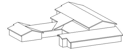

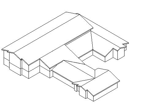

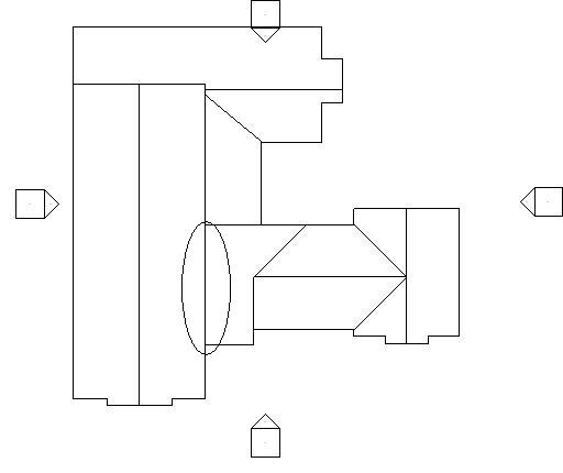

I have a roof that has something screwy going on with it. The circled part of my roof is not joining together with niether roof nor geometry. What should I do? Is there a way to actually make those two pieces at once with the same roof instead of two seperate roofs? (The backside of the slope is supposed to over-lap the lower roof.)

first you want to make sure its of the same material and then all you should have to do is cut a section through it and make sure it is aligned perfectly in you section and then i would use join geometry to connect the two.

no go. The materials are the same, they are lined up perfectly, and still nothing. It says that it is joined now after I did the geometry, but the only lines that dissapearred are on the faicia, the roof-top line is still there.

Try join geometry first, then try join roof if it doesn't work
Or copy and paste just the roof to a file and post it here. just make sure you purge the file before you save to get rid of anything that's not used to get the file size down.
Other than that, the roofs, if aligned and joined, the line should disappear. If you had an error when you joined, then it could be different roof pitch or your edit lines aren't completely attached to the other roof. They don't necessarily have to be the same roof material or the same type of roof.

here are the striped plans. Thanksfor any help you can provide.
