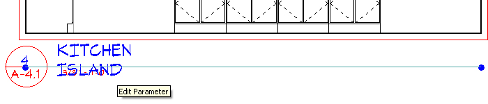

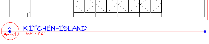

Hello there,
 Ok so I am having similar problems with my view title.  The only thing is I can't get my title to no get cropped and automatically return to two lines.  If I have: KITCHEN ISLAND for my view title it will show it as:
KITCHENISLAND.
Not: KITCHEN ISLAND.  But if I title my view as: KITCHEN-ISLAND It works fine and doesn't write it out on two lines.  I need to make it so it writes on one line only because, the bottom line of text is sitting ontop of the scale.  Look at the images I attached.  They explain themselves.
I have gone into the Annotation Family and make the 'View Name' Label really long and this did not fix the issue.  Does anyone have any ideas that can help?  Thanks,
Lorne
