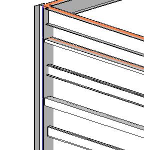

.Below is a link to a great video and written tutorial on how to use the Beam System to easily create a Girt System.1. Create a new reference plane and name it.2. Sketch the beam system outine on the new ref. plane.3. Specify the beam type and spacing style.4. Finish and ......Bob's your uncle.http://revitrocks.blogspot.com/2007/03/wall-girt-system.htmlDG
