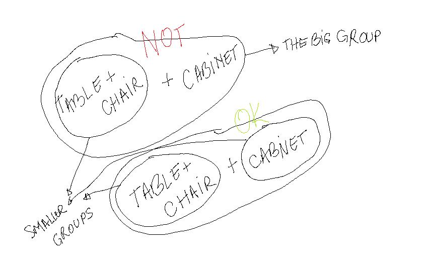

had the same problem a while back...
i found that using a group that contained another group and some objects did this a lot.
the partial solution was to use only groups to make up the bigger one. and not a combination of objects and groups
