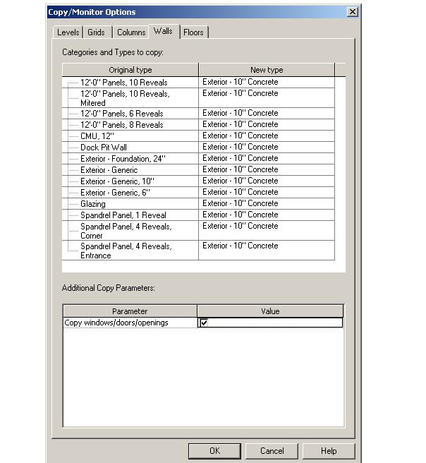

   The question is, is it possible to copy openings by copy / monitor? In Copy/Monitor option– at the bottom of the wall/floor tab(under additional copy parameters), it gave us option to select wall openings but, when I tried it seems doesn’t work. Any ideas…
See attached file..

It worked for me, pick the arch wall with the openings and it copys the walls and openings all being monitored.  Debating on using that for our shear walls so it will tell me when they decide to move the openings
