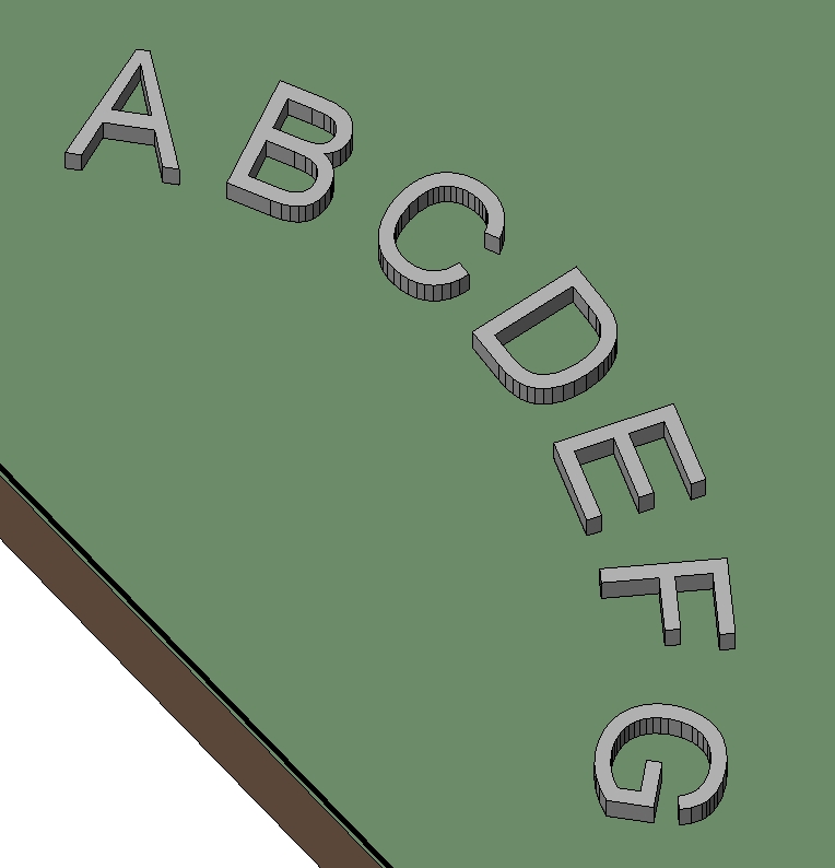

this is my first post and would like to know it it's possible to have the model text follow a curve. i want to attach the text on a curved wall.
any help would be really appreciated.
thank you.

I have done this. I created 1 letter, arrayed an arc with the number of letters I needed, then change the letters.

thank you for the quick response. i will try that.
if you guys out there have other ways of doing this please let me know.
