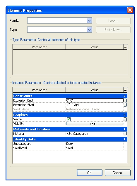

I have created a new dinning table, out of oak, but when I render it comes up as the default material. Any advice would be great.
                                                                    Thanks,
                                                                    Jim III
Tue, Mar 6, 2007 at 2:04:19 PM | Creating new componets
robinballew
robinballew Avatar
Joined: Sun, Nov 27, 2005
298 Posts
3 Stars: 4 Votes
Add an object style in your family call "Table" or what ever. Attach the model components to the object style. You use the Subcategory under Idenity Data. When you load the family you will be able to adjust the material under the object style.
