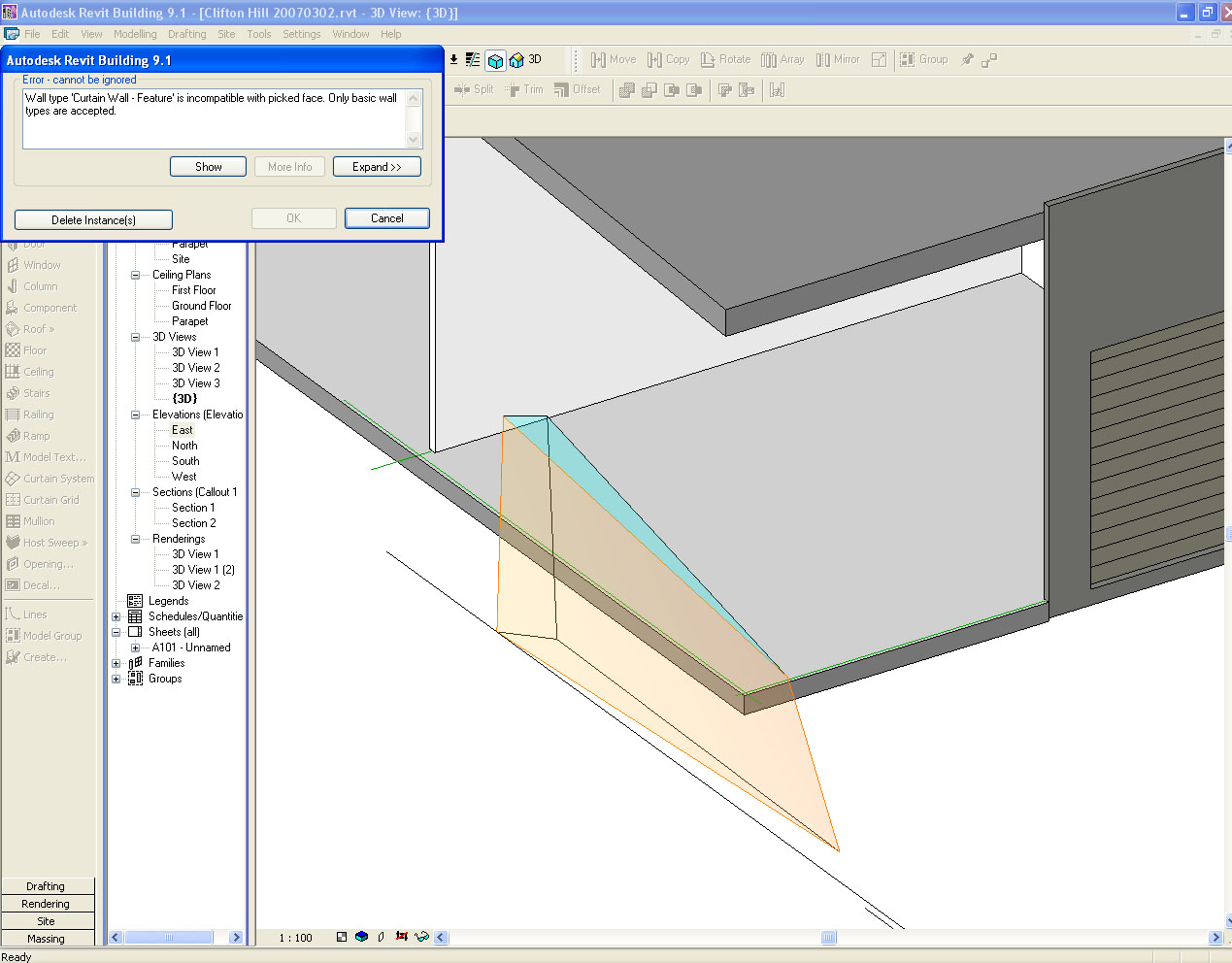

Hi all,
I am struggling  on this issue... i have tried to create a mass with profile i want, but the curtain wall won't what attach to the face >< (Refer picture attached)
Is there a better way? Or will it just not work???

OK, OK...
I may have rushed this post in a panic.... just after i made it i tried the curtain system by face command... and all is good now.
Thank you (in advance) to anyone who would have  replied.

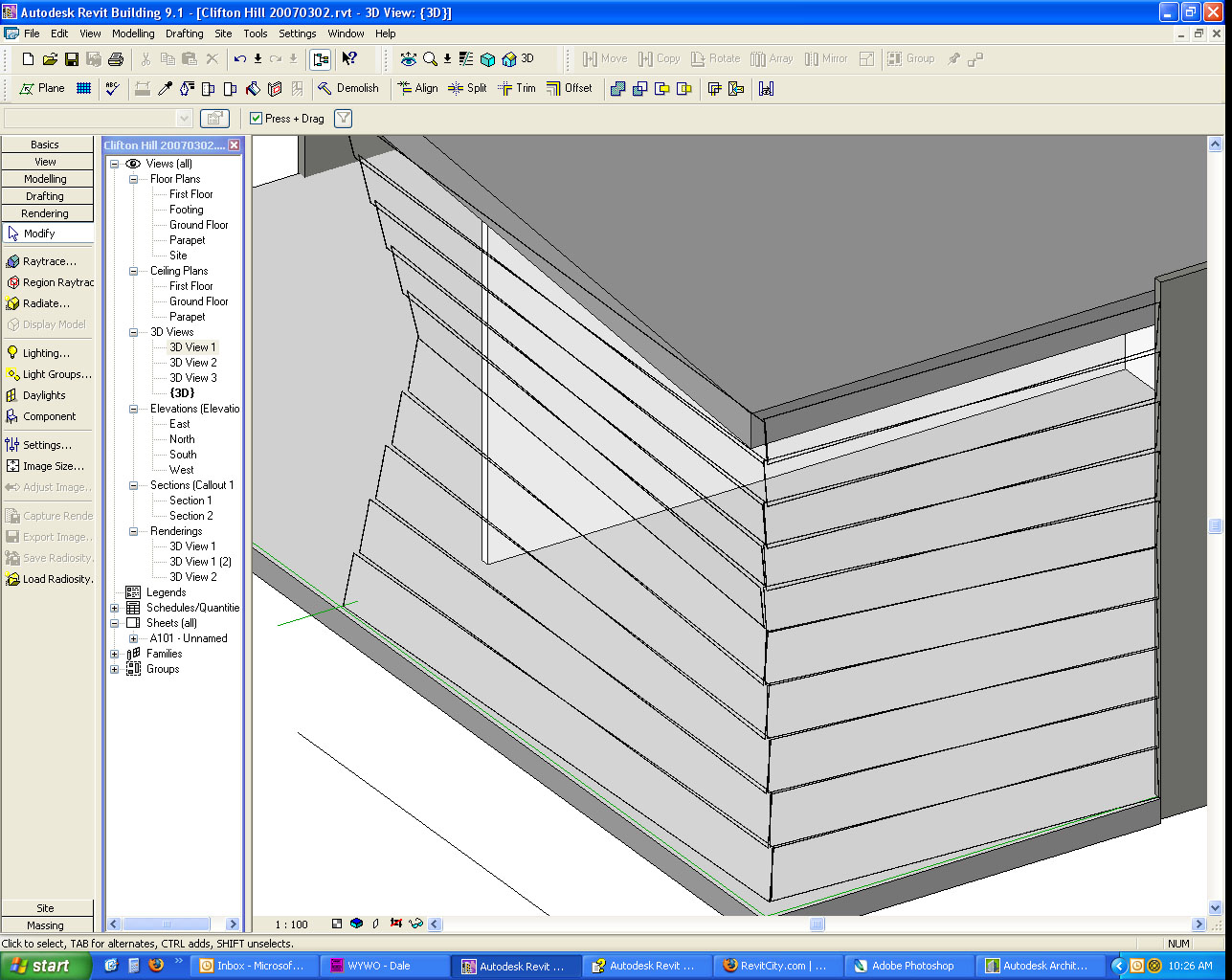

Further to this problem now that i have the whole angled wall thing working, the system panels do not seem to align to the grid???
View the attached .jpg to see what i mean. My next problem with this that when i insert a 150x50 mullion they don't align at the corners... this is quite confusing and frustrating - is there as simple solution - or is it simply too complex for revit to handle?
