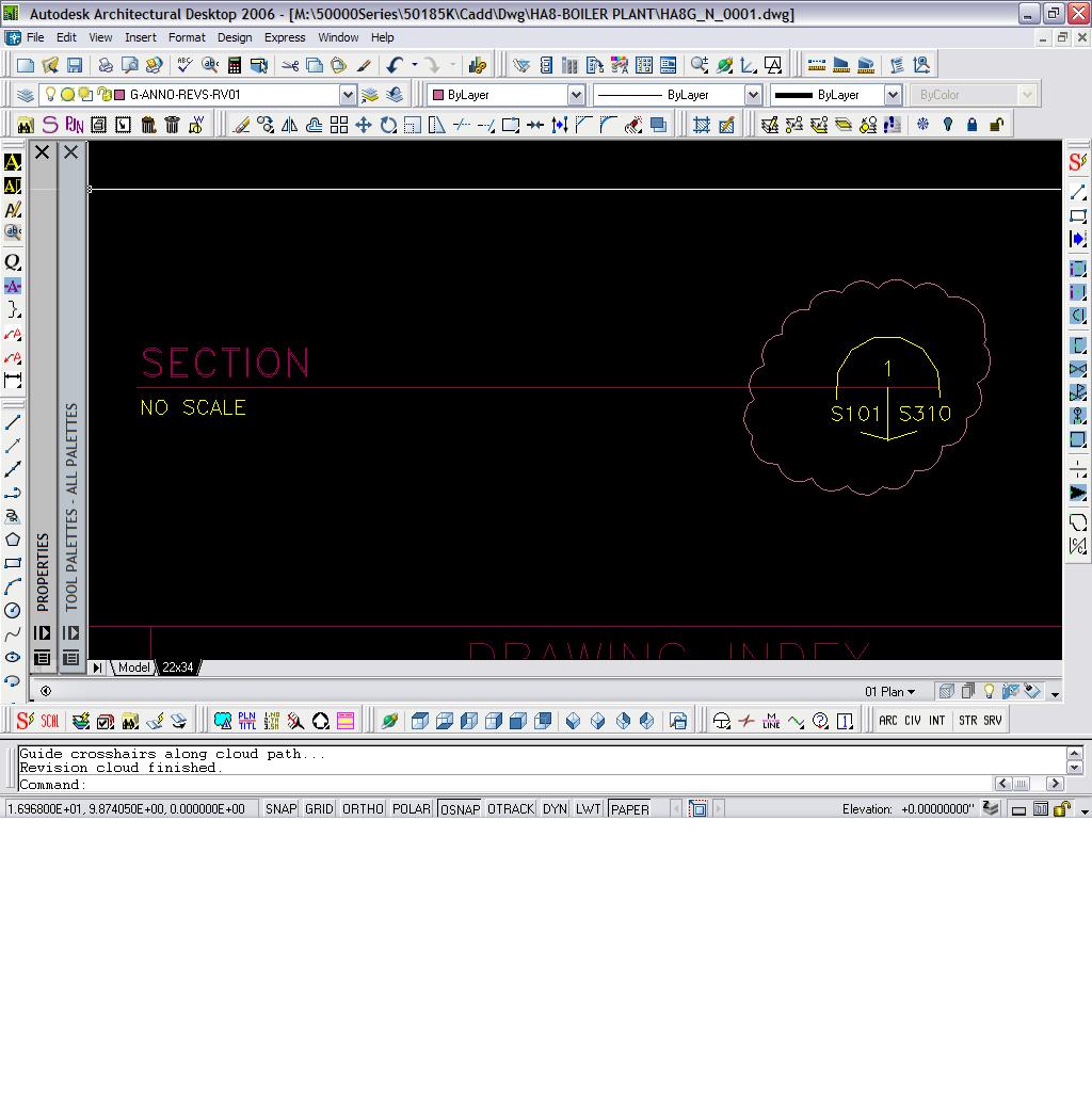

Quick question. As I create a section sheet and drag the section view into the sheet, we would like the title of the section to have the symbol clouded in tha attached jpeg. I have created another family to allow enlarged text in the view title but I can't seem to find where Revit looks for the identity part of it.
Any help would be welcome.

I created a new family, and started with the View Title.rft under Imperial|Annotations. To use it, you will need to create a new Viewport type. The easiest way I know of is to select the viewport, go to properties click edit/new and duplicate it. In the new viewport properties, change the Title to the new family. As for the parameters used in the title, just open it to see what lables I used. Hope this helps.
