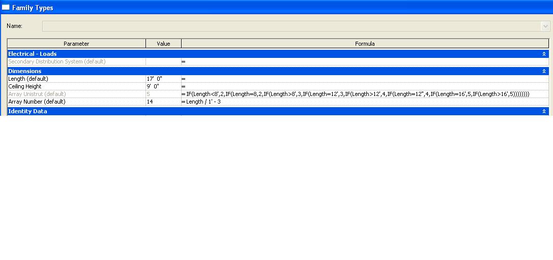

I am trying to work on a parameter formula to allow me to correctly flex a component. See attached image.
Here is what I need the parameter formula to do:
Length<=4' THEN 2
Length>4' upto and including 8' THEN 3
Length>8' but less than 12' THEN 4
Length=>12' but less than 16' THEN 5
Length=>16' THEN 6
That is it....let me know if you guys have any ideas in mind.

Mon, Feb 26, 2007 at 5:36:57 PM | Parameter Formula
TomDorner
Joined: Sun, Apr 25, 2004
1207 Posts
4.5 Stars: 25 Votes
You can follow these guidelines for some more ideas.
• Use conditionals in the definition of the parameter whose value is conditional.
• In the Formula column next to the appropriate parameter, type the formula for the parameter. Noticethat the formula begins with an equal sign (=).
• IF based on one test statement: =IF (Test Condition, Result if true, Result if false)IF ( Length < 35' , 2'-6", 3'-0" )
• IF based on more than one test: =IF (AND/OR (Test1, Test2) Result if true, Result if false)IF ( AND (x = 1 , y = 2), 8 , 3 )IF ( OR ( A = 1 , B = 3 ) , 8 , 3 )
• IF based on a negative test: =IF ( NOT (Test Condition), Result if true, Result if false)IF ( NOT ( A > B ) , 8 , 3 )
• Simple result if True, another IF if false: =IF (Test Condition, Result if true, IF (Test Condition, Result iftrue, Result if false ))IF ( Length < 35' , 2' 6" , IF ( Length < 45' , 3' , IF ( Length < 55' , 5' , 8' ) ) )
• Set one YES/NO parameter to the opposite of another: =NOT Y/N Parameter
The question though is a complex conditional formula the best solution? Depending on what you are making can the array be driven by a type catalog? Can you do a first/last array and evlauate spacing via a formula that is simpler? Having a multi-nested conditional formula can lead to performace problems within the family. Of course that may not be a problem if you only have a couple of occurances within the project. If you have hundreds or thousands of them, then it is a different story. Without knowing more details it is hard to say what is the best option.
Edited on: Mon, Feb 26, 2007 at 5:38:09 PM

Mon, Feb 26, 2007 at 8:21:02 PM | Parameter Formula
Sumex
Sumex Avatar
Joined: Wed, Oct 11, 2006
14 Posts
Try this...
 If (Length < 3'11 63/64", 2, (If (and (Length >4' 0",Length < 8'0 1/64"Winking, 3, (If (and (Length >8' 0",Length < 12'0"Winking, 4, (If (and (Length >11' 11 63/64",Length < 16'0"Winking, 5, (If (Length < 16' 0 1/64", 6, 0)))))))))
Length must be a Length Parameter, and the Object parameter to be an Integer.  Less than / greater than or equal to (<=, >=) don't work, so you need to make determinations on tolerances.  I used 1/64th in this case.  You also need to have a "Catch all" which is the final Parameter, for any open loop, or instance not covered.  It acts as a check.  I used Zero (0).

Tue, Feb 27, 2007 at 6:09:11 PM | Parameter Formula
Recit
Joined: Mon, Oct 30, 2006
25 Posts
Guys, after all your suggestions, here is the winning formula:
if(Length = 16', 5, if(Length > 16', 6, if(Length = 12', 4, if(Length > 12', 5, if(Length = 8', 3, if(Length > 8', 4, if(Length > 4', 3, 2)))))))
I learned that it makes a difference the sequence of numbers. That is to say that in the above formula begining from the bigger number and ending with a smaller number allows me to end it nicely. the numbering sequence is critical in the formula's behavior. In this case a decreasing sequence works much better than an increasing manner because it closes nicely with the last TRUE,FALSE)
