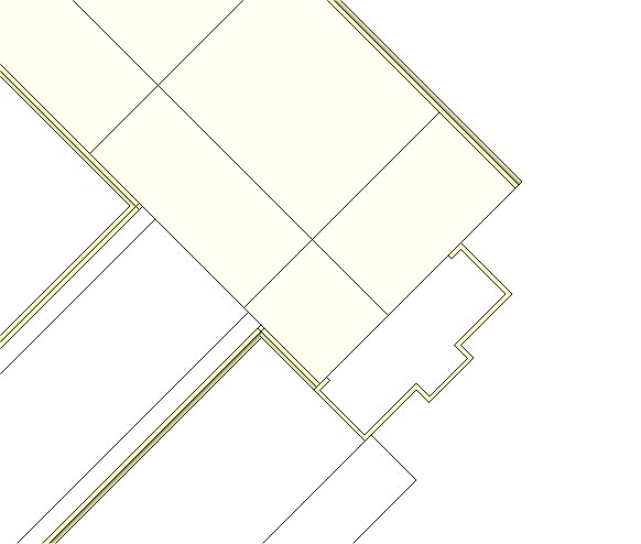

This masonry wall has a 4" vinyl base sweep at the floor.  The wrapping is set at inserts to be "interior" and at ends to be "both" in the attached image.  I have reset the insert wrapping to be "exterior" and achieved no improvement.  I have modified the standard Revit door to make the wall opening at the outside of the door frame and have inserted a frame profile sweep to achieve a more correct door drawing in plan, elevation, and 3D.  I have a neat entry to a typical classroom at a large daycare facility for handicapped children.  I want to show a closeup view of the corridor door situation to my client's board and the wall base looks really stupid since it doesn't wrap around the corner at the door frame.  Any suggestions on how to "fix" my problem?  Preferably one that doesn't involve laborious pounding on tab until some shape handle appears and manually dragging the sweep end around the room.  There are over 200 doors in my project and I would like to be able to show my clients ANY OF THEM without the building information model making the 3D view look stupid and I don't have time to manually fix them all.  Does Revit have a neat fix for this problem?

I don't believe you can set wall sweeps to return at openings like you can wall components.
I would add the base to my door family and be done with it.

Your asking way to much.  REVIT will do it - if you want to use something other than wall sweeps.  Wall sweeps don't return at openings because they don't see the return as a wall and really - that may be something you don't want.  Sweeps are great because they are adjustable along their length.
If you want to take the time, then redefine your wall as a stacked wall with the vinyl being a component outside of your brick and set it to return at openings.  Of course, when you do that, you'll loose the ability to independently adjust the base along the bottom of your wall.
REVIT will do it if you want to.

 This might be obvious but can't you pick the sweep, click on "change sweep returns", click "return" and change it to "90". Then you can drag it back to the door opening? I just tried it, works fine. Keep in mind the easiest way to adjust the sweeps is in the 3d view.

Sorry, didn't see the quantity of doors. I would add the base profile sweep to the door family with a return to make it complete the look. The same way you would add trim to a door family. If you want to get fancy you could create a wall based family that has the sweep profile, import it to the door family adjust constraints and then update your model. Then if you need to you can keep adding different sweeps to the door family for the different base styles. I just tried it and it works fine.
