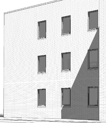

I am having an issue with texture maps behaving correctly at levels.  On my exterior elevations and perspectives, there seems to be a void in the texture at the level lines.  This leaves a strange condition when trying to convey an accurate brick pattern.  See attached image between first and second floor line.  Any thoughts on how to correct this?  Thanks

it looks like you pattern is missing the horizontal grout line there which would lead me to believe that the hatch pattern isn't aligned properly. you can select your hatch lines by tabbing through if you've never done it before.

Common problem when stacking walls (constraining from level to level) or editing wall profiles. One reason to constrain your exterior walls from top of foundation to roof level.
Try this and I believe you will see this problem dissapear.
