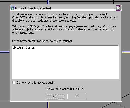

My revit version is 9.1 and 3d studio max 8 see attachment for error warning object DXB.
The model has the same colors as in revit, but there are no materials connected to it.

Your materials should import into Max just fine. I think it was since 7.5 it imported materials. Are you saying that all your materials don't show up? Have you rendered in Revit just to see if the materials are really there first? I don't know much about object enablers, but from your screen shot you should check out the autodesk site for that. You have something missing somewhere.
If you are missing materials on your walls, maybe post a small revit file with some walls that have the material problem and I can take a look at it for you.

i get the same message as well wish i could fix it
