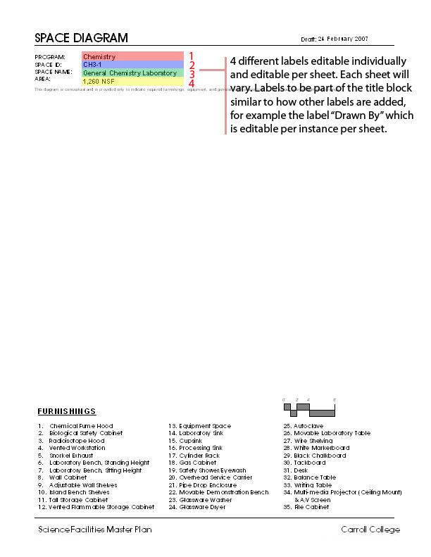

Hi Everyone:
I need to make a title block that has 4 labels editibale each seperately per sheet (instance parameters) when the title block is in a sheet.
Please see attached image for graphical example. I want to edit the labels similar to how the "Drawn By" labels work in the title sheet per sheet per instace, but without being part of the project information parameters.
Thanks.
-R
