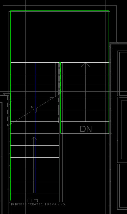

I created this stair, and for some reason, one of the stringers (see image: the back one on the longer/lower run) has offset itself from the stair and other stringers.  The difference can be seen where the stringers end on the low side of the stair.  I thought this was a fluke and remade the stair, but still had the same problem.  Any idea why the stringer is doing this?
Thanks a lot!

I'm assuming that's one run of stairs. If you're looking for a way to correct it, I'd just make 2 stairs there instead of one.
I haven't the slightest why that's doing that. Maybe it might be the tight turnaround from your landing. It is strange.

Yea, I guess that will be the easiest way to deal with it.  Thanks a lot!

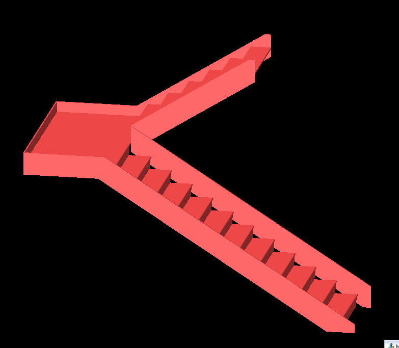

I see the landing has smth like stringer, a horizontal one.is it a seporate "mini" staircale with one big tread as a landing?or the whole thing is one stair with the landing?

I am having the same problem with several of my stairs.  wtf.  I dont want to redo all the stairs as single runs that doesnt make an sense.  Revit 2010 + update 1.
Wed, Jul 15, 2009 at 2:20:56 PM | Stair Stringer Offset
Move your runs apart.  There needs to be a very short landing line between the teo runs.
