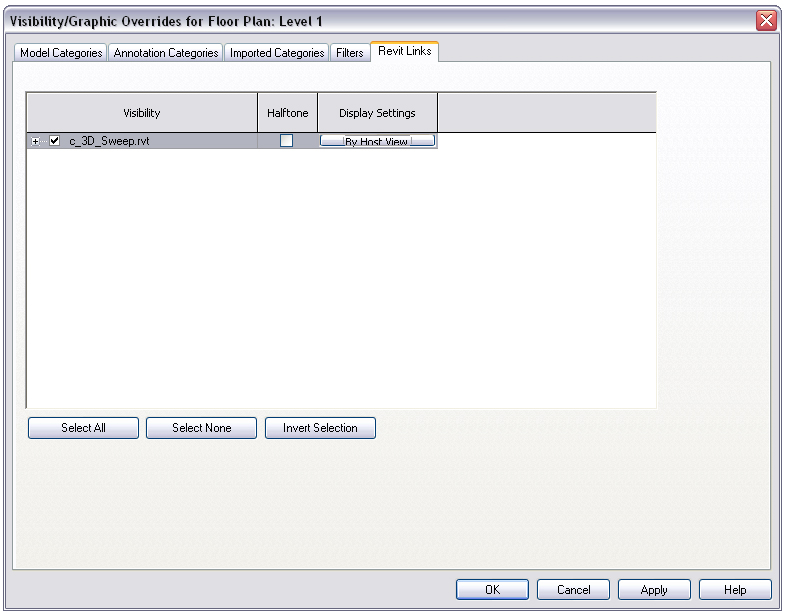

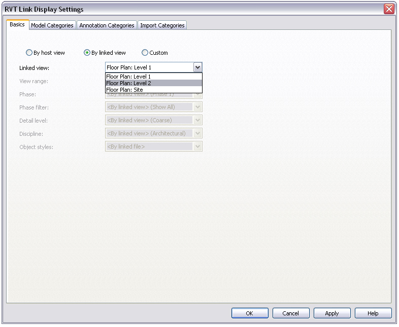

You can't tag elements that are in a linked file.  You can, however, display the annotations from a particular view in the linked file.  To do so go to visibility/graphics and select the Revit Links tab.  Select the "By Host View" button next to the appropriate link.  Once the dialog opens, select "By Linked View" and select the view that you want to display from the linked file.  See the attached images.

 The 'by linked view' in elevations is greyed out as an option.  Even setting to custom and turing on the annotation doesn't  make the tags in the linked file visible.  Works fine in floor plan views though.

yes, thanks.  i did find the grayed out option when i followed that path.  yes the plans work ok cause you can manipualate the settign to by linked view.  any way to get around this.  I cant seem to even manually place a window tag in the linked file
