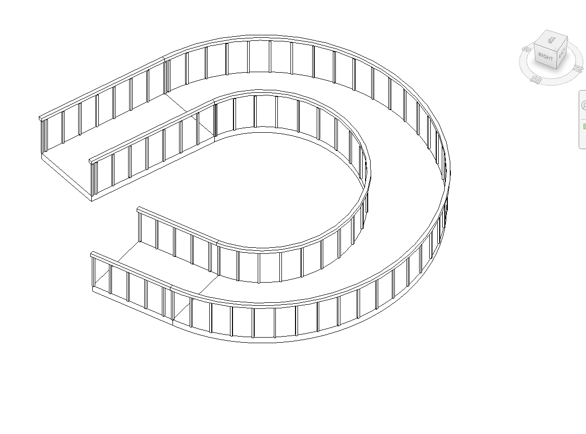

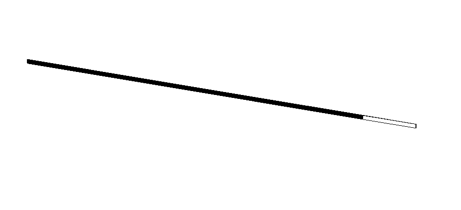

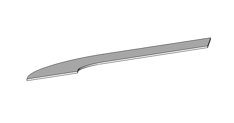

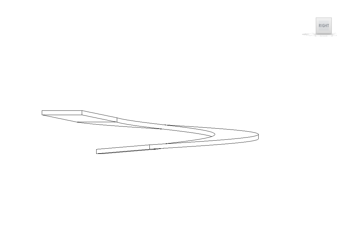

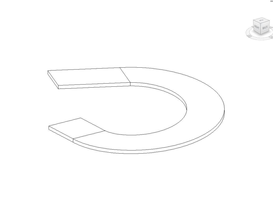

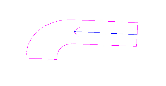

A sloping floor won't work because you can't define the slope to follow the curve, the slope arrow works only in a straight line. Even if you only define the grade using a slope arrow, you will find that one end of the won't be co-planar with the level you are connecting to. (refer attached images)
These are from current project, and this is bugging me. Is massing the best option???

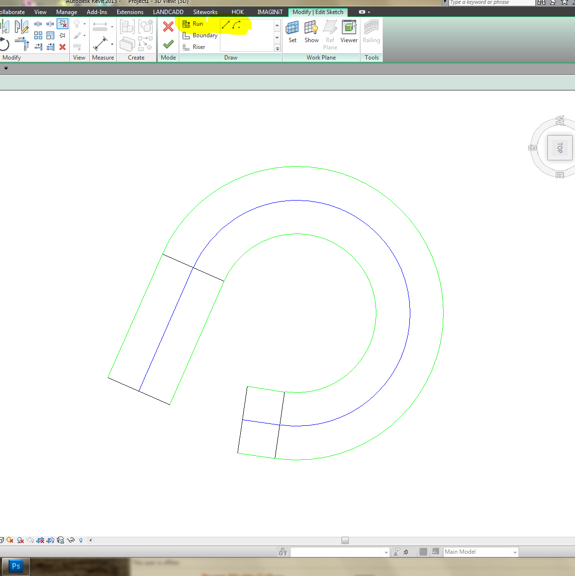

Try to create ramp using run tool.
Hope it will work..
