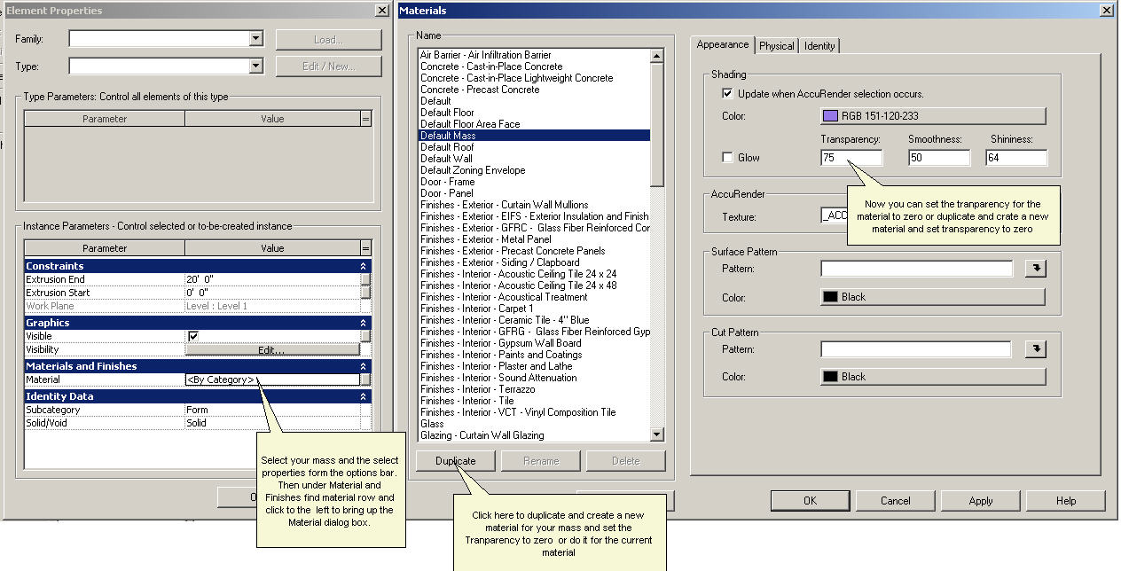

As a new user to revit, i am always learning, i have created a mass object within my wall construction to represent a feature keystone type object, the mass is transparent and see through, how can i apply a solid hatch and material to this mass.

select your mass and click properties in the option bar and take a look at the attached image
