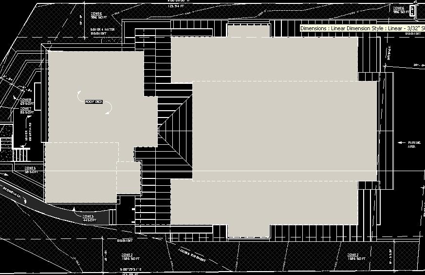

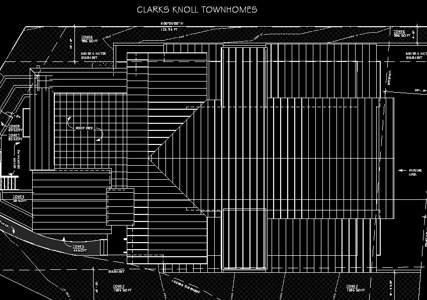

I WANT TO ADD A SHADED REGION TO A BUILDINGS FOOTPRINT IN A SITE PLAN.  SOLID FILLS HOWEVER WON'T ALLOW ME TO MAKE A SEMI TRANSPARENT FILL.  SEE ATTACHED IMAGES.  I DON'T WANT TO USE A TRANSPARENT LINE FILL PATTERN BECAUSE THE LINES MAKE THE DRAWING LOOK TO CLUTTERED.  I KNOW THIS CAN BE DONE IN AN AREA PLAN, BUT THIS IS A SITE PLAN.  ANY SUGGESTIONS WOULD BE GREATLY APPRECIATED.

THIS DOES NOT WORK BECAUSE WHEN YOU SET IT TO A SOLID FILL, IT WILL GREY OUT THE TRANSPARENCY BOX.  EVEN THOUGH IT MAY SAY TRANSPARENT AND IS GREYED OUT, IT WILL NOT PRINT TRANSPARENT.  ANY OTHER THOUGHTS?

In Revit 9.1 anyway, it is not possible to create a solid fill that is translucent/transparent. This seemingly basic functionality simply does not exist. A user might want to do this to mask of existing construction, or for a dozen different reasons. While existing construction can and should be built with phasing controls to distinguish new from old, a large filled region can really (and easily) make a drawing clear.
The best workaround I found was to create a drafting pattern of very dense dots, and use that pat for the filled region. If you zoom in close enough you'll see the dots, but plotted, or zoomed out on a PDF, in looks like translucent gray.
