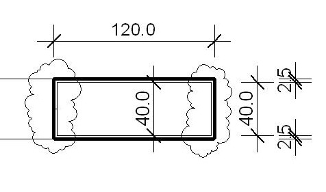

How can I dimension the core of a wall wrapped at both end sides? I need to place dimensions at both sides of the wall. The wall is 25mm render / 150mm Structure (Core Boundary) / 25mm render

set your dim pref. to faces of core.

It works only for the vertical dimension (already done), the problem is for the horizontal dimensions, Revit only let me check the faces not the core of the wall

I HAVE NOT HAD THIS HAPPEN TO ME. BUT I SEE WHAT YOU'RE SAYING NOW. UNTIL YOU CAN FIND THE PROPER WAY TO DO IT YOU MAY TRY DO DRAW A SMALL LION AT THE LOCATION YOU NEED THE DIM AT THEN DIM BETWEEN THE TWO LINES I HAVE HAD TO DO THIS FOR DIMS BETWEEN STAIR WELLS TO SHOW HEAD HEIGHT CLEARANCES. SINCE I CAN NOT DIM A VERTICAL DISTANCE BETWEEN TWO SLOPED LINES.
