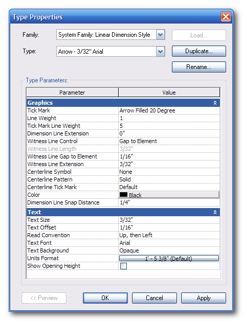

We've got Revit Structure 4 and I'm trying to tweak my templates.  Our default text styles are all set up to use 0.8 text width but our dimensions are showing up as 1.0 text width.  I cannot find any place to make the change specifically in dimensions.  Is it supposed to match the regular text style?  I thought so, but it definitely does not.

try Setting => Annotations => Dimensions

Thanks, but there is no setting in there to change or specify text width - not that I can see.

Try going under the drafting tab and write out a line of text (the text you want to change) You should be able to change the width that way (under properites) and then the change should show up in the dimension text.  HTH
