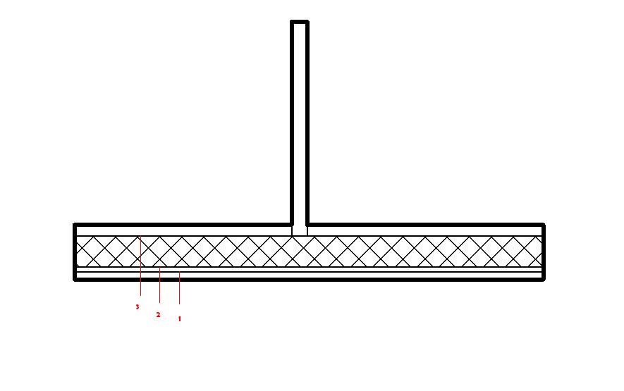

Hi guys. I need a little help
Please take look at the attached photo.
My questions are:
1. How do I make the interior wall attached to the finish of the wall and not to the Structure of the wall?
2. Can I make lines 1,2 and 3 in different line weights? CryingI need line no. 1 to be a very thin line)
3. How can I make the hatch lines of the  Structure part of the wall thinner?
Thank you a lot!
Thu, Jan 25, 2007 at 6:38:47 PM | A few questions about walls and line weights
framerman
Joined: Tue, Jun 29, 2004
543 Posts
4 Stars: 13 Votes
I think on #1 you can select the wall, put your cursor over the blue dot on the end you want to join to the finish, right click, select disallow join and adjust from there. Another way maybe is (if the wall is different) to go into the wall properties, edit the wall and change your priority levels (1,2,3,4,5) as far as how the finish joins there.
#2 I don't think you can use the linework tool there, but give it a try and see what happens.  That is a very peculiar question now that I think of it. What designates the lineweight of the walls that you draw? How does Revit know what to put there?
#3 I don't think that it's possible to change the lineweights of hatches. Another good question as to how Revit decides what lineweight to put there?
