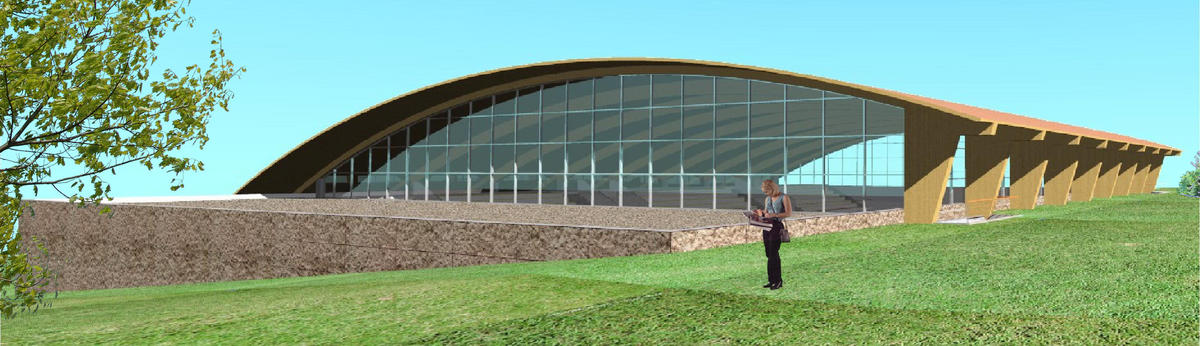

This may sound like a dumb question.  Im in a novice Revit class and i can't seem to figure out how to do a roof with a radius.... like a round roof... or a semi-circle..
please help... thank you
Tue, Jan 23, 2007 at 12:58:45 PM | Roof
pomona
Joined: Tue, Jun 20, 2006
3 Posts
the only example that I can find of what I want to do is here http://www.revitcity.com/gallery_images/3519.jpg
it's a similar design I guess...

One of the roof creation options is "By Extrusion". I recommend looking at the tutorial for this type of roof. As a newbie to Revit, I found that the tutorials are very helpful.

the roof in the picture you posted can be easily done with the roof by extrusion method. Go to your side elevation and draw the curve you want.

thanks, that helped a lot.
