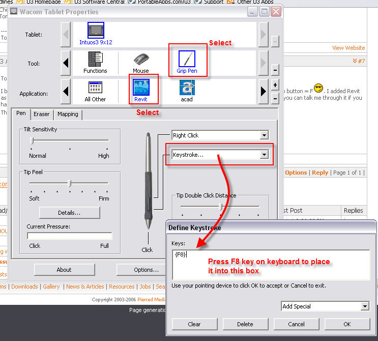

Tom,
I bought the table you recommended...but I can't seem to reprogram it to the setting you described below (e.g. Top button = FShadey. I added Revit as my application, but thats as far as I gotten. I'm sure I'm missing something simple. If you want to I'll call you and you can talk me through it if you have a few minutes to spare.

Alan,
Start the Wacom tablet properties from the Windows Control Panel then follow the attached image to reprogram the pen settings.
Post again if you are still stuck.

Tom,
Got it.........I just need to highlight both at the one time........I love it already.
 Take the afternoon off on me!!!!
