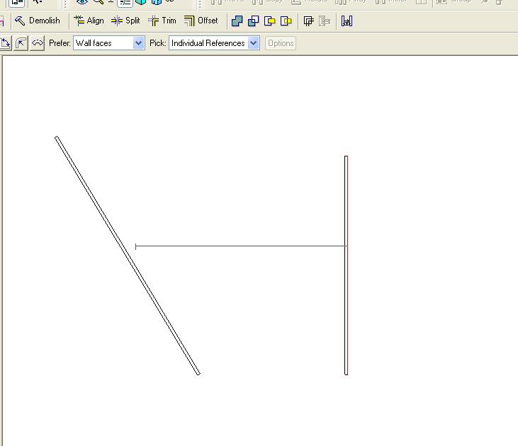

Only way to do that, would be to draw a line parallel to the straight wall that bi-sects the midpoint of the angled wall and then you will be able to dimension. HTH

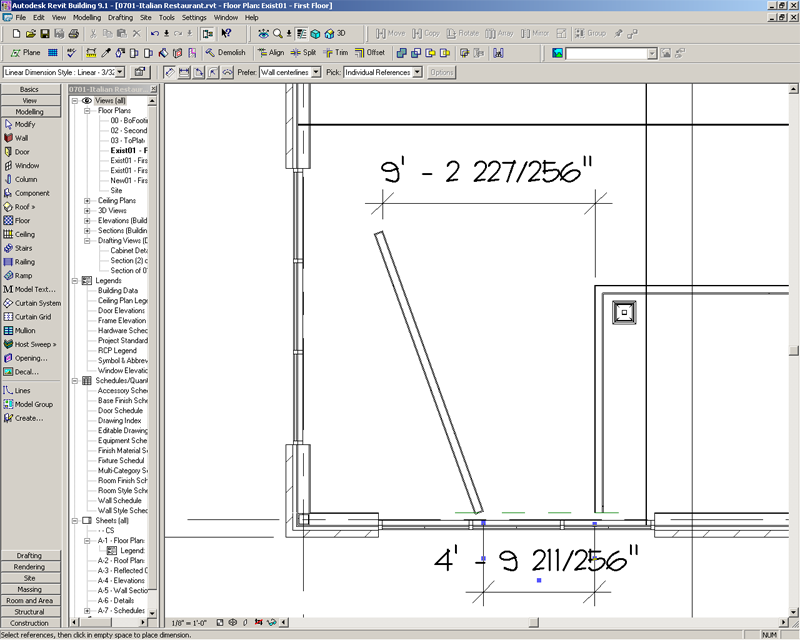

Just to be the devil's advocate here: How will someone else reading that drawing know where on the non parallel wall that dimension occurs? I don't know what the circumstances are but if this is to be for construction, you'd be better off dimensioning both ends of the non parallel wall to the other wall separately giving a contractor a better guide of where to lay his sill plate. This being the case you can actually use the endpoint (Type 'SE' when dimension to snap to end) of the non parallel wall as a dimension point.
See attached photo.  I found that I could only dimension to the corner of the outermost layer of the wall assembly (ie: these dimensions are outside face of Gyp Board in this case to the corner of the outside face of Gyp Board on the non parallel wall.)

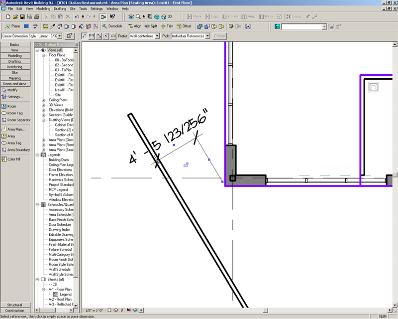

In some cases I do need the dimension form other points of the wall (see photo - I want to show the width of the pass between to buildings)

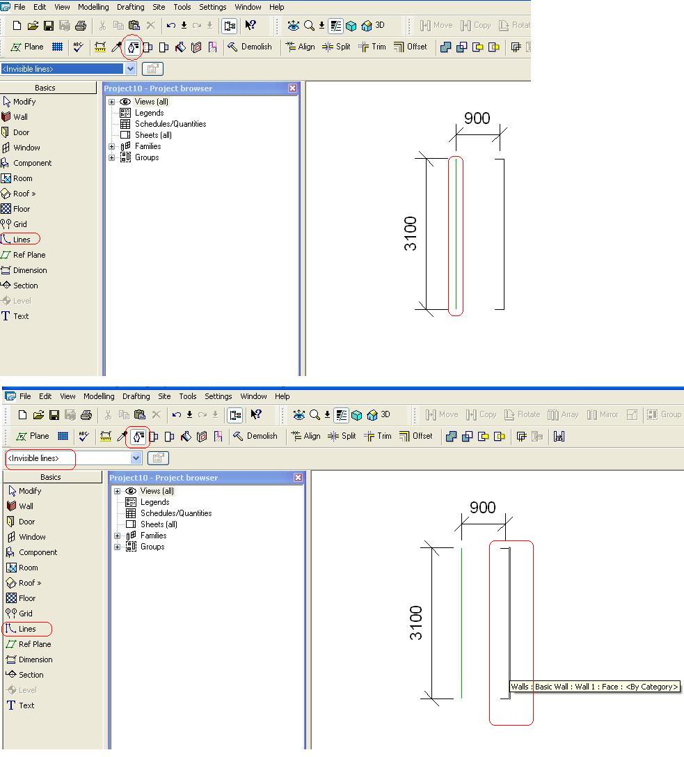

you should already have an invisible line. I want to make sure you are clicking the right icon though.
draw the line, dimension it, then select the linework tool which is the ink pen looking thing next to the eye dropper on the (edit bar?) click the arrow for the drop down list and <invisible line> should be there

Look at the picture please.
In the first picture I hovered over the line and it didn't accept the linework command
In the second one I hoverd over the wall and it highlighted.
I've circled in red all the commands  I have used

sorry, my fault. I thought for sure I had it set somewhere in my file.
You can make a new line in settings and make the color white so it won't print, or you can move the dimension over the top of the line to appear as one.

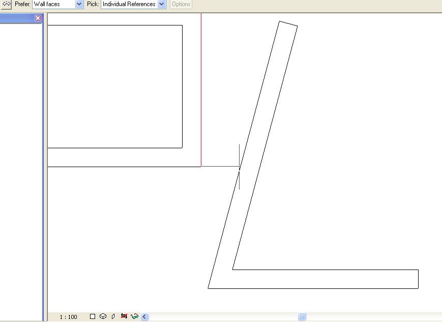

See the attached image.  You can dimension directly between two walls like you are showing.  Just select the angled wall first then select the corner of the wall which makes the pass you want to dimension.  If the corner doesn't select, hit TAB a couple of time till the point you want to dimension to is selected.  It should select automagically however since it won't dimension to anything else but a point on that wall.  This is, of course, assuming that there is a corner to snap to, I would imagine if there were no corner, however, that there would not be a pass between the buildings.
