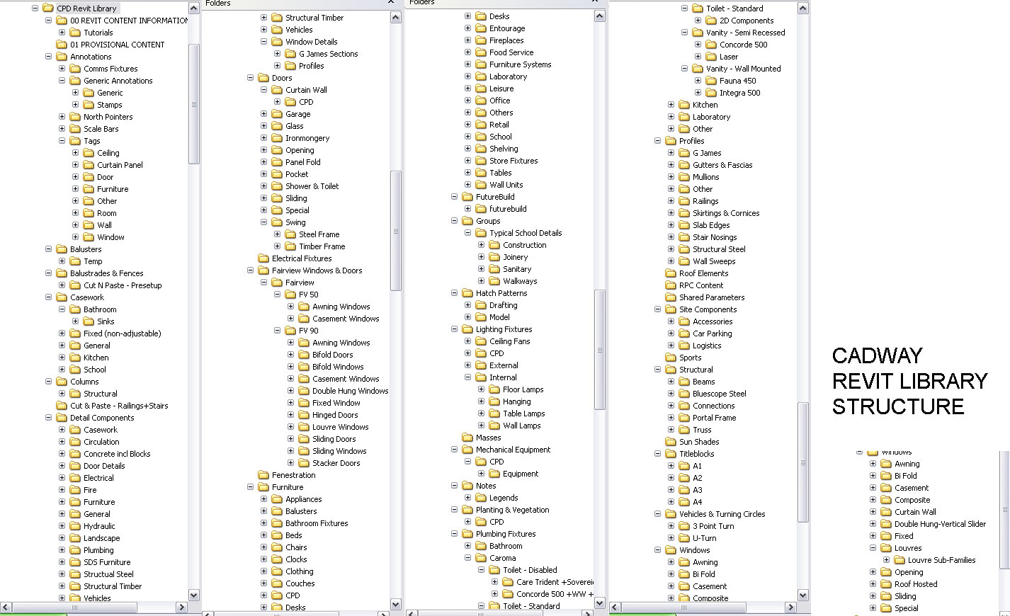

Its really a matter of "What is going to be the easiest way to find things?"
Every office is different as it will depend on the knowledge of the staff and how they think.  If they are used to thinking in the CSI format then this may be easier for them.  If they generally aren't familiar with this format then perhaps a more straight forward classification is in order.
In our office i've basically taken the standard revit classification and modified to better suit our needs.  Refer the attached screen shot for an outline.

Hey thanks guys...this has been really helpful.  Our firm keeps going around and around about the right way to organize stuff...we have like 3 different libraries with different family's in each and its just a mess.  I'm definitely leaning towards the library structure like yours Mr. Spot...its pretty intuitive and already works with the way Revit has families set up...but I can also definitely see the benifits of setting it up in CSI format.
I noticed in your library structure that you do not have a folder for "Speciality Equipment"...that folder is one of our main areas of concern because it seems so general but it also applys to many different objects, like fire protection equipment, or toilet accessories - grab bars etc, even ADA symbols and things like that... What do you do with general speciality equipment like those?
