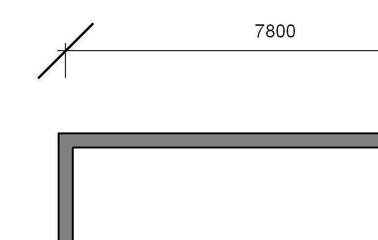

Does anyone know how to add a parameter to a dimeniosn style? Or..how to create custom dimension styles?

Dimensions are 'system families' and as suchyou can only access and change what you see in the 'properties' of the dimesnion.
What in particular are you trying to accomplish?

vcen i am facing the same problems with dimensions....
we have this various types of "ticks" in the properties of dimensions like arrow, dot, and diagonal ticks.....what if i want a diagonal tick of different dimension then what is present in the list...

Go Settings-->Annotations-->Arrowheads and there you can make whatever tick size you want.
