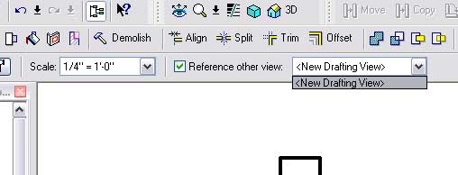

Hi,
I have been a member for a while, but this is my first post here.I have searched around for an answer, but haven't been able find it yet.On our Revit Building model, we have cut sections through the building, and have then taken some 'call outs' for enlarged details from these sections.Is it possible to display on the elevations, where these call outs occur?It would be useful to reference where particular details occur on both the sections and Elevations, but without having to manually add them to elevations. With a callout, the reference would be linked.I hope this makes sense, and appreciate any advice offered.CheersMJ
Sat, Jan 20, 2007 at 10:42:49 AM | Displaying a 'call out' tag from a section or plan on Elevations - Possible?
TomDorner
Joined: Sun, Apr 25, 2004
1207 Posts
4.5 Stars: 25 Votes
Callouts in a section would not automatically show up on an elevation unless possibly the elevation view insersects the callout.
Revit does provide a way to place a callout that references another view.  When placing a callout pay close attention to the option bar above.  There is a box that you can check called 'reference other view'.  Check this box and you can select the callout you want to reference.  You only get one shot at this option and that is before you start placing the callout.
Maybe this option will work for you.
Tom
