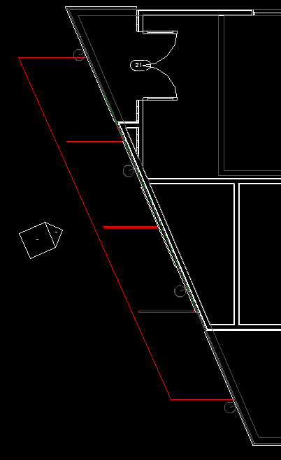

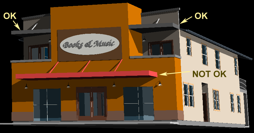

As for grouping and exporting, worked for some things, but not all.  If anyone is interested, I've included 2 snapshots of one item that did not want to work with this method. "There is no Group that can be placed in the current view" error when trying to place it in any view.  Maybe I screwed up when making it, I don't know. Newbie here Smile
