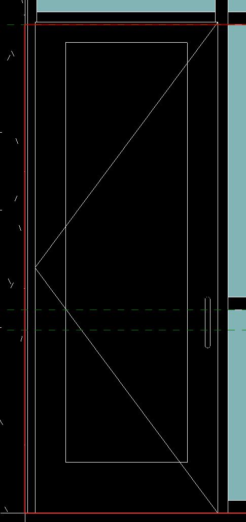

DId you ever get this?  I am trying to find a door that looks and acts real.  I am using the Tubelite system but can't find a door that works right.  This is what I get.

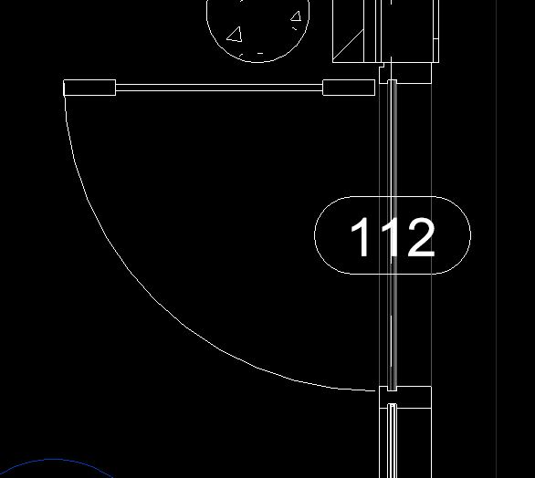

Still looking for a door that fits inside the mullions like in real life.  Why is the door bigger than the opening?
