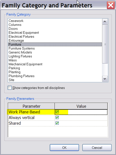

Thanks Tom for sharing.  Just thought I'd add a tip for others who may find this thread.  To change a family to workplane based...while editing family go to Settings Menu and choose "Family Category and Parameters".  Then choose check box for workplane based.  See attached image.  After reloading the family you'll then be able to use rehost function to select the desired plane.
