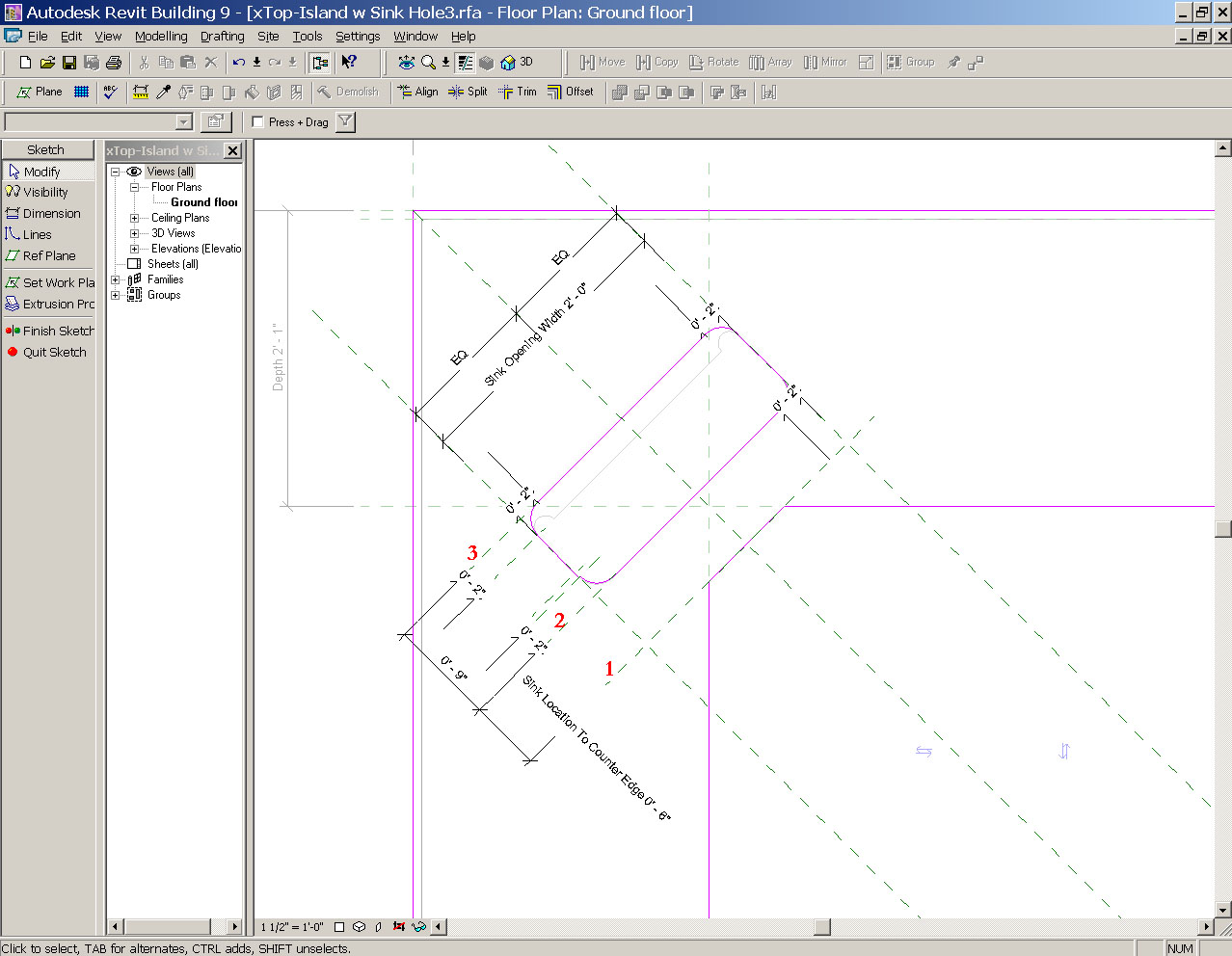

I am trying to create an adjustable family so that a sink opening changes in size within the counter (see attached image). The problem I am having is that everytime apply a diffent label to the dimesion that applies to the reference planes of the opening (2&3) it makes the counter larger (1). Any ideas on how to control which reference plane moves when the dimension is changes?

I can't really answer that as I have the same trouble. What I do now is try and set up all the ref. planes before I start adding the model. That way I know everything will flex how I want it to.
