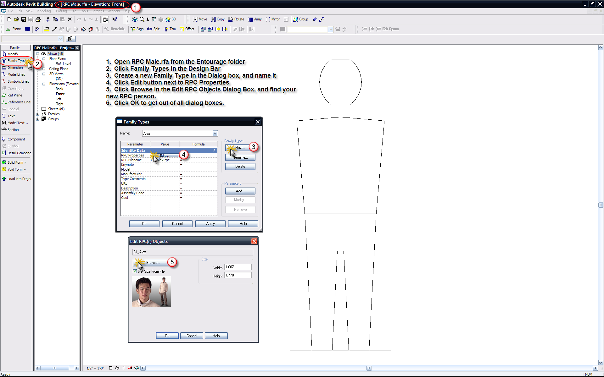

I am interested in using RPC content in renderings......how do I import them into the model???

you must assign the RPC images to one of the RPC_Male.rfa or RPC_Female.rfa Revit families.  Find those in the entourage folder and open one of them.  Yuo will see how they are assigned.

so would it be under properties - materials & finishes?

see attached screen capture and instructions
