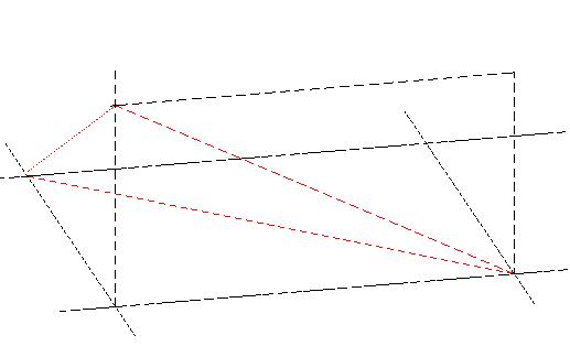

1. free working plane:I only find the possibilty to work in orthogonal working planes based on grid. Is it possible to define or work in a free working plane like red lines shown in picture "workplane" based on three points or coordinates or other objects ?

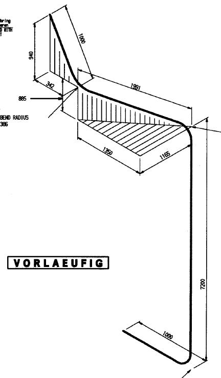

3. 3D-Path:To generate piping as a 3D-Sweep, it would be very helpful to have something like 3D-Path or Sketching based on coordinates x,y,z and angles. Modellines always depend on a workingplane and it is not possible to scetch them in an 3D-View in x,y and z-direction. Do you have any tips for me how i can generate pipes like shown in picture "piping" ?

1.  From your image it looks like you can achieve what you're after by setting a reference plane in plan and then setting that as the workplane and drawing the sketch in an orthagonal view or a 3D view...

3.  I'm pretty sure Revit Systems has great tools for doing this, but its limited to that at the moment.  For structure and building you have to set workplanes first.   Sometimes a good idea is to draw your path with model lines first so you can work across multiple planes, then use pick path which doesn't limit you to a single plane for a sweep provided the path can be linked.
