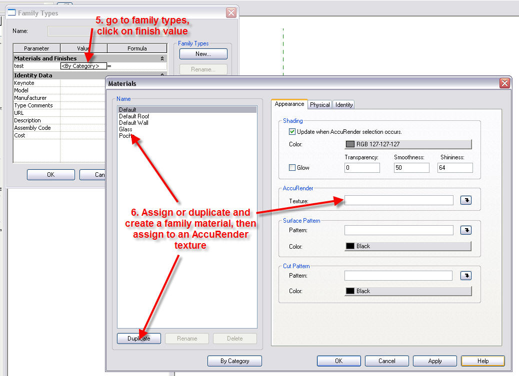

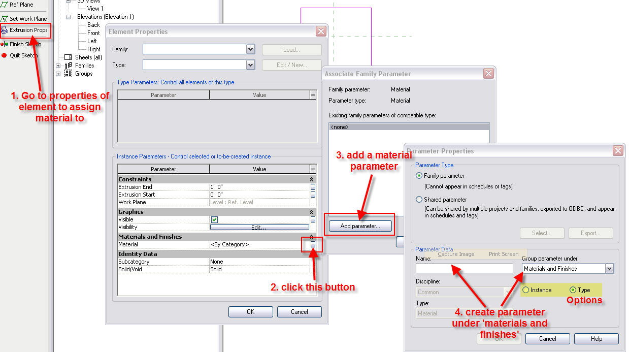

Tue, Dec 12, 2006 at 4:51:32 PM | materials and finishes
TomDorner
Joined: Sun, Apr 25, 2004
1207 Posts
4.5 Stars: 25 Votes
You need to go into the properties of each object in the family and create a new material parameter that exposes to the user the ability to change the material definition.  See attached images for a better explanation.
Tom
www.reviteer.com   http://twitter.com/Reviteer
Wed, Dec 13, 2006 at 12:41:12 AM | materials and finishes
vector23
vector23 Avatar
Joined: Sun, Apr 23, 2006
265 Posts
2 Stars: 16 Votes
unbelievable! thanks very much tom.. i still don't know my way around in the
family editor too well yet.. that was just great.. thank you thank you..
