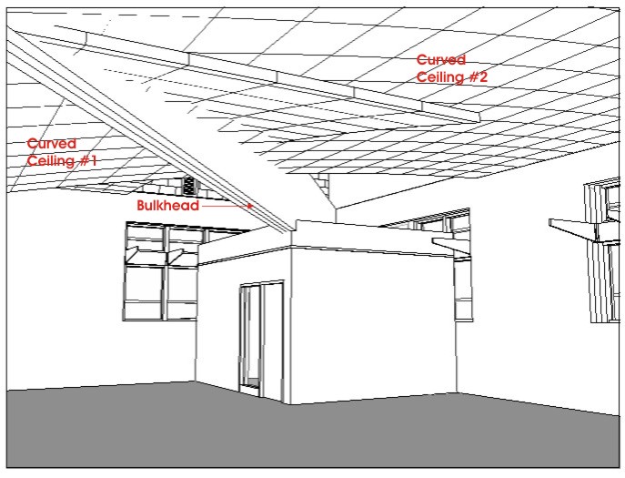

I create a ceiling with various level in a room and I get difficulty in placing lighting fixture onto the ceiling. It just snap to one level of ceiling. When I try to place it to the different level, it doesn't appear. Any suggestion?

I am having the same problem and I have a presentation do tonight. Did you ever find a solution

Not sure how you deal with that. Quickest solution I can think of is making another 'fake' ground level and associate the second ceiling plane with the new level, then you should have 2 seperate reflected ceiling plans. Then be sure you place the light on the correct ceiling plan. HTH, best of luck to the both of you.
