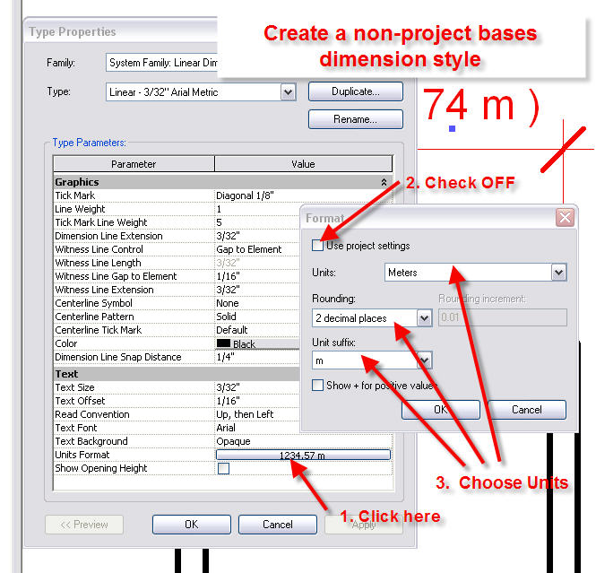

It is not something that Revit can do.  The best I can come up with is to place two dimensions on top of each other, one using the project units [say imperial] and then another defined as metric that does not use the project units but over-rides them to metric.  You have to move the text of one or both dimensions from on top of one another and add the prefix/suffix of your choice.
The other option is to have the two dimension styles and create two views one metric and another imperial.  Dimension one view then copy/paste the dimensions to the other view and change them to the other dimension style.  You can then place each view onto a sheet on top of each other or seperately.  If on top of each other then yu would have to move the dimesnion text in one of the views.

Sorry, almost four years later the answer is still the same.  Revit cannot do alternate dimensions like AutoCAD.  The only other option now I can add is export to ACAD for dimensioned plans now that the CAD exports from Revit preserve dimensions.  In earlier days they cam out as lines, tick and text.

Unless someone builds an add on to do this, your optios are:
  1. Use two strings
  2. Use text for one of the trailing dimension.
Now for the out of the box answer..... Use two strings with them both in the same place and spread the text apart....
Darn ... Tom beat me to it....and I see the out of the box he already had too.
