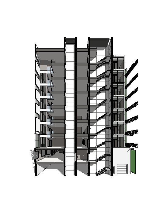

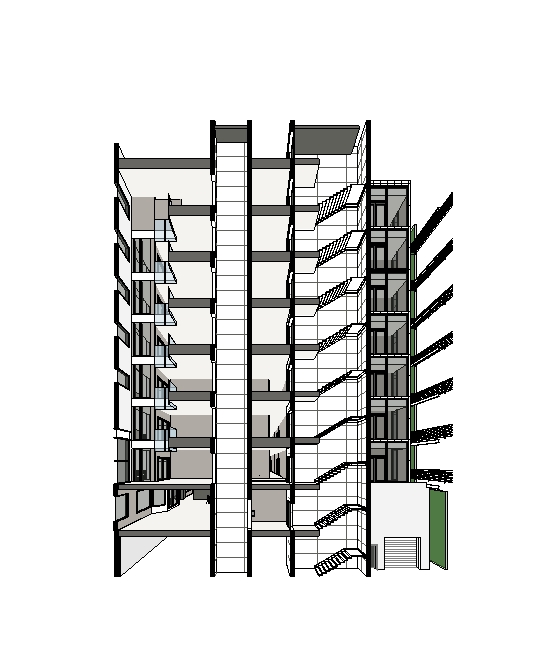

I'm always a little late to respond, but I think I might have this one kicked.I can't print it out to check it over very well, our plotter died.  But it looks good.
Made a section.
Made camera view.
Cropped my camera view to show the whole building, AND oriented this view to the section I'm using.
 Then I turn on Section in the view properties of my camera view.  I select hte section box, and go to my plan.
Since I selected my section box before going to plan the section box is visible, and I adjusted it to be aligned to the section mark.
 Like I said it looks good, and I actually think it is what your looking for, or possibley the closest thing I could find to that..
Good Luck
