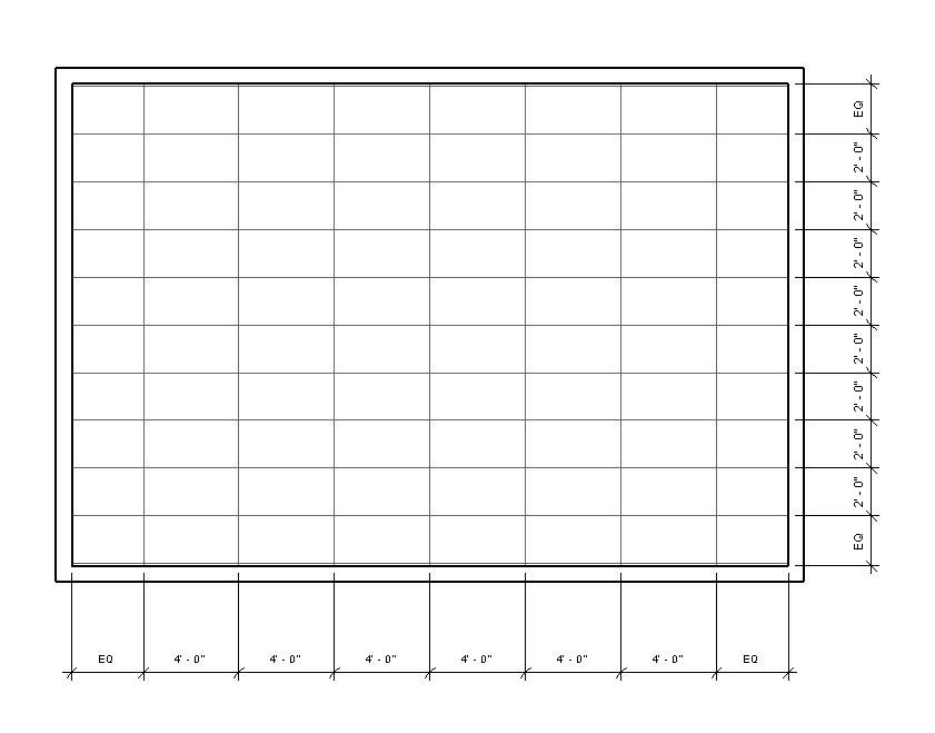

I think that WWHub is talking about something a bit different than the rest of you.  You guys are having the EQ symbles in dimensions that are right next to eachother.  WWHub is talking about something that isnt possible in revit and it is where you have a string of 3 dimensions and the outer two are equal.  So you have EQ-6'-0"-EQ as an example rather than EQ-EQ.  You also can not make two dimensions that arnt connected both say "EQ"  the example of this is for ceiling grid, I want both first tiles to be the same off both wall sides of a room, and can have a dim say EQ on both sides.  I hope this clarifies any confusion.

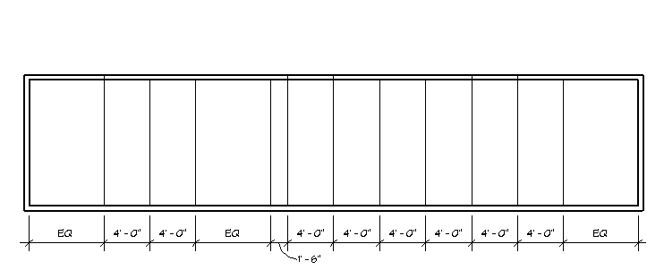

Doing what normanoid suggested should work. I did a quick example of the this situation. Check out the attachment

Wow, ok cool, thanks for proving me wrong haha.  Thats cool though, never new you could do that for a string of dimensions.  Whats odd about that though is that if you were to have an Equal segment in the middle as well it wont do that though.  So with my example have EQ-4'0"-EQ-4'0"-EQ, but still cool none the less.  Thanks.  Still though so my credability doesnt all go the hell now, you can have two unconnection dimensions set to equal eachother.  At least Im 50pct right, unfortunatly thats still failing haha.  Thanks for pointing that out James

Edit on this is being annoying, I could post the attachment but not add to my comment...then i couldnt go back and delet the attachment.  Anyway the attacment above is a way to get the EQ in the middle by just breaking it into 2 strings.

A couple of things to keep in mind when you are dimensioning in this manner.
A string of dimensions that have multiple equal dimensions will not show EQ. broncos4life (Go Cowboys again) is correct...for example, EQ-4'0"-EQ-2'0" will work, but if you add two feet to the last dimension it will read 1'0"-4'0"-1'0"-4'0".
Also, be careful because different dimension strings act independent of each other. For example, you are detailing a garage door and the the widths of the panels are all EQ dimensions and the heights of the panels are all EQ dimensions, but the the two EQ dimensions are not the same. In a detail like this we will typically only show EQ on both if the EQ's are the same (ie, square panels). Just a thought.
