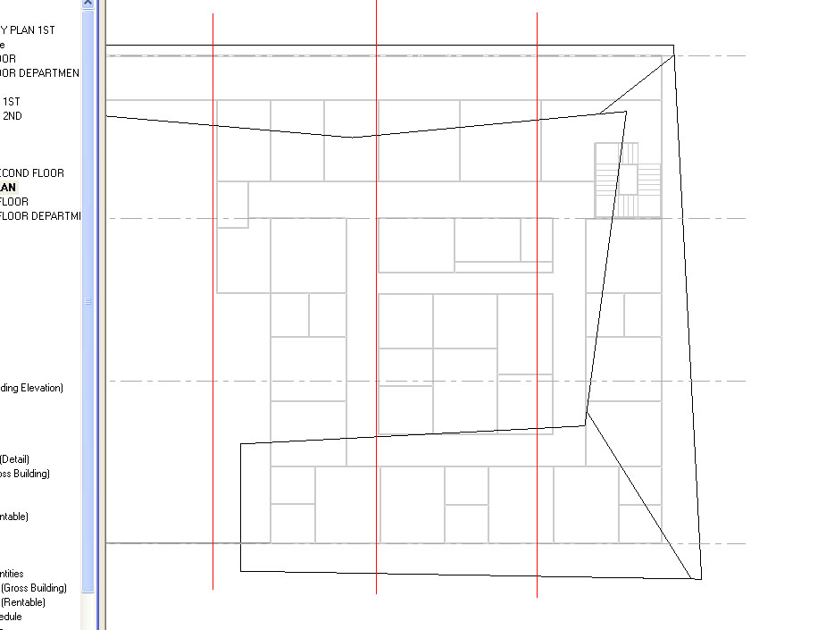

I have trouble with seeing my column grid on my roof plan. in the attached jpeg, there should be column grid where the red lines are at. Its just odd that the one grid (horizontal) is showing up but the one (vertical) isn't. Any suggestions to why that is? Thanks!

Make sure that your grids are 3D and their extents intersect the level of your roof plan.  Go to elevation views to see that the grids go up to the roof level.  You can also right click on a grid and "maxamize 3D extents"

Thanks for the tip!
