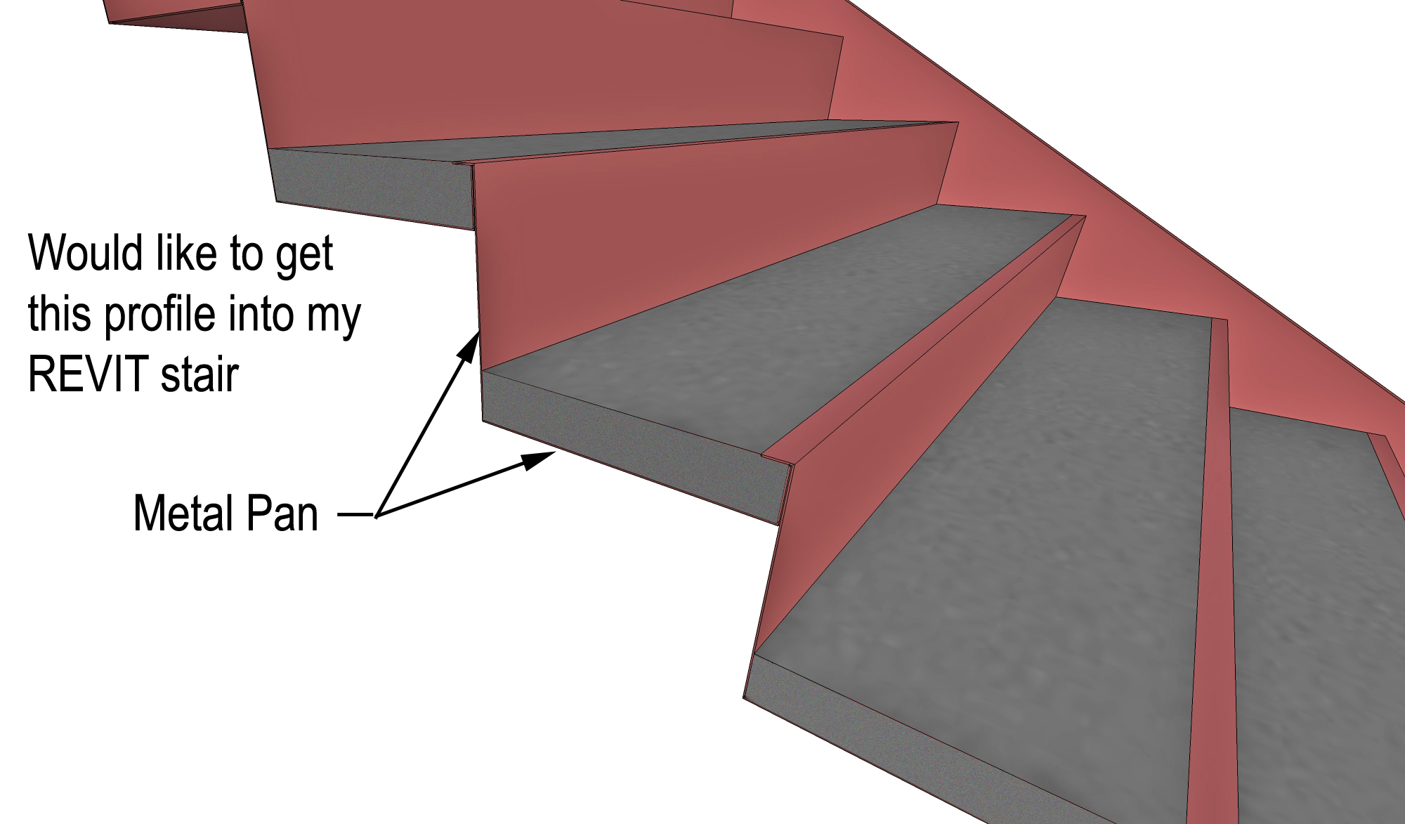

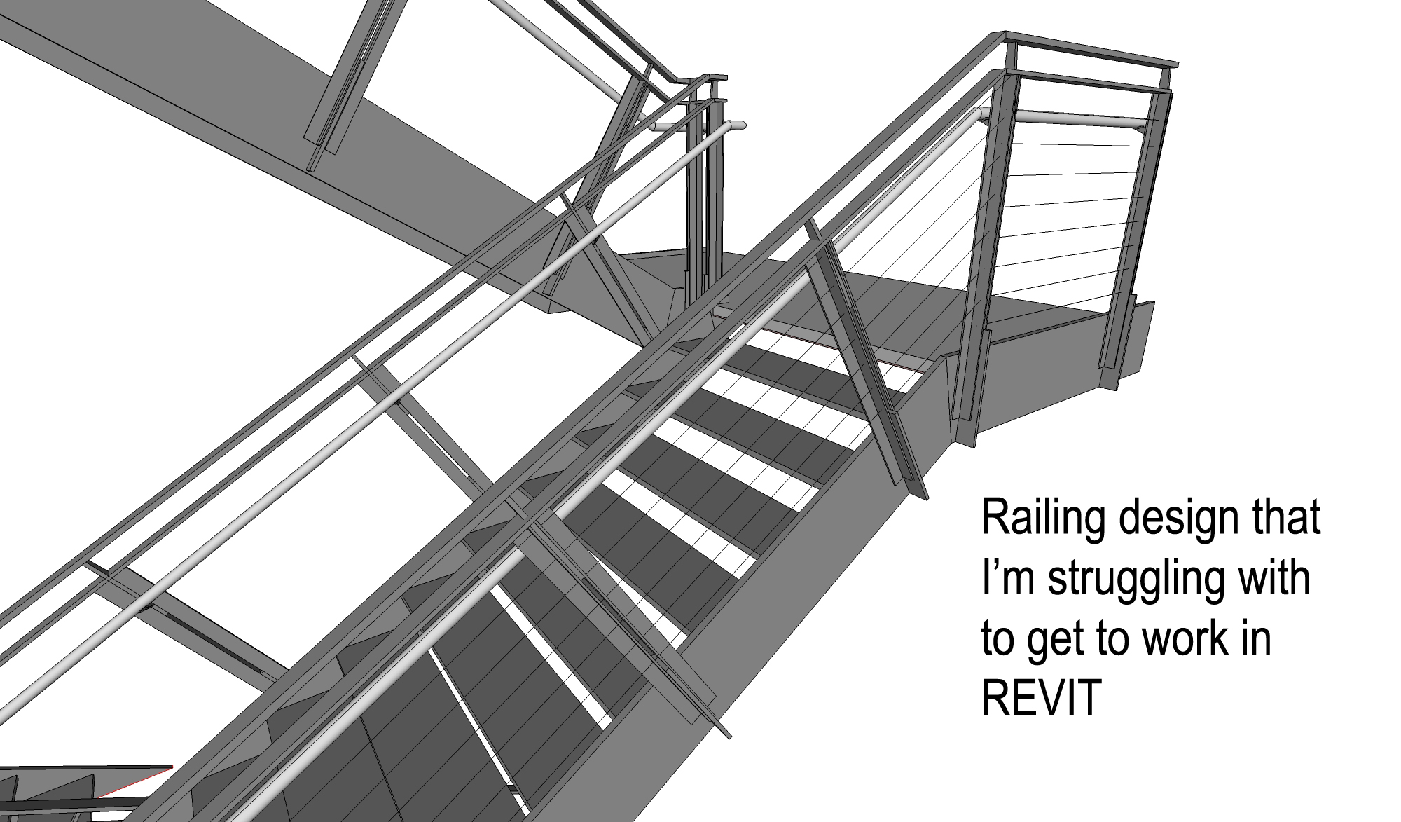

I need assistance with a few issues that have come up. First of all I'm trying to create a railing with Balusters that are perpendicular to the stringer. I've been able to edit the profile of the baluster for shape desired, but when I change the baluster to perpendicular to the stringer, it can't read when the stringer becomes a landing and is still attaching itself at at the same angle that it is shown on the angled stringer.  Any help would be great, In addition to this I'd like to show the stair section/profile to be conc. filled metal pans? any tips on customizing this profile?

I would just draw the railing that is on the landing as it's own railing.
Sketch the railing in different sections. This makes making custom railings a little easier. Also, when you are sketchnig, you might have to "set host." As for the metal pans, I would just detail that. There is a metal pan detail somewhere in Revit that you could use.

That seems to work.
