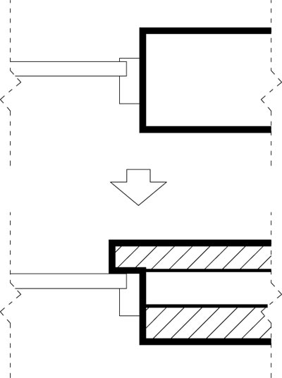

im just new to revit, thrown on deep waters...
i would like to modify each window/wall meetings in plan, what would be fastest method to do that? Please see attached picture, illustrating my problem
regards,chris

I would open my window family delete the opening and create a void that would cut the wall to that shape for me. This way it will update over the whole project for that window.

would there be a method involving drafting(with simple lines/fills)  over that part of building, so drawn in one place would update in every case found in project? or do i need to dive into family editing for wall endings and window shapes?
