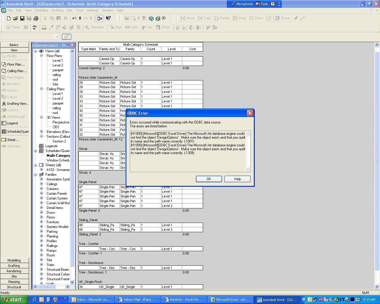

Hiii...I'm new to Revitcity forum. I have a case confusing me recently. When I create a multi-category schedule, it doesn't display all building elements created. No floor, wall, roof, etc. I need to make it for building cost estimation. Someone suggests me to export to ODBC but I'm still don't understand with this feature since I'm new to Revit. Anyone can teach me? Thx. Smile

IWhen I try to open the Excel file there's an error message and the file couldn't be opened. Here's the error message.

Interesting. Try this first: Go to File-->Export-->ODBC Database... Where it says DSN Name click NEW. Navigate down to 'Microsoft Excel Driver (*.xls)' Make sure you pick this name exactly. Click NEXT, Now Give it a name, ie Microsoft Excel Click Finish. Now select the DSN you just created and click OK and select the *.xls workbook you wish to export to and click ok. Hopefully this should work.

It works!! Thanks alot Mr. Spot. Then.... I have to fill the cost for every family's type? The cost parameter is just appear in family's type not in family right? And I have to link and paste each data to new sheet one by one? I hope it's my last question...Puh
