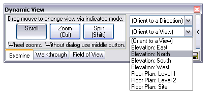

First you need to have a view that you want to render...for example an elevation.  Then create a camera view.  Open the camera view and go to view/dynamically modify view (see attached image)  From there you can click the tall, narrow arrow and choose orient to other view - choose your elevation.  Voila! you can render it!
