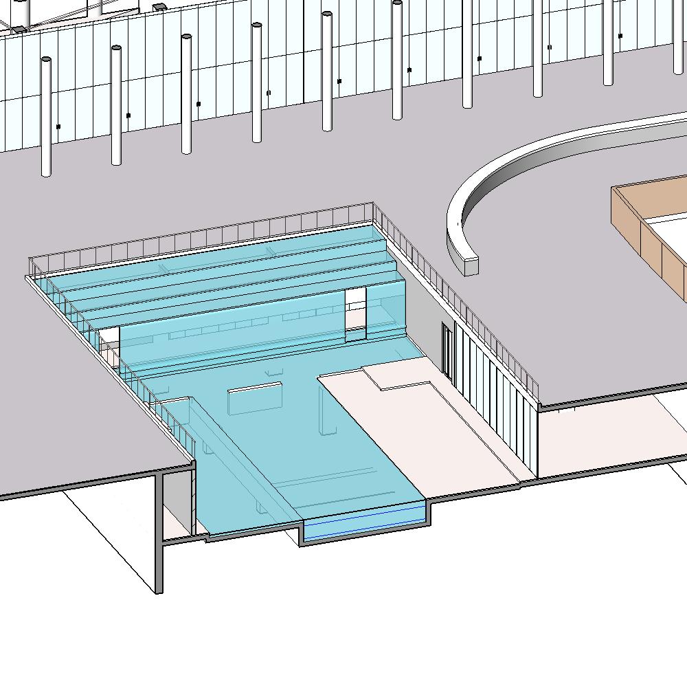

Hi, I made a pool as a floor with a concrete base (core layer) & assigned a transluscent water property to the upper layer (finish 1). it works great in section but in the view, the materials misbehave. the whole floor takes the property of the water - which is trasnsluscent, & the base of the pool - which is concrete also shows transparent. please see attached cut 3d.
i tried inter- changing the layering of materials in the floors but it still looks the same. short of making an additional solid floor below is there anything else i can do to make only the water layer transparent ?

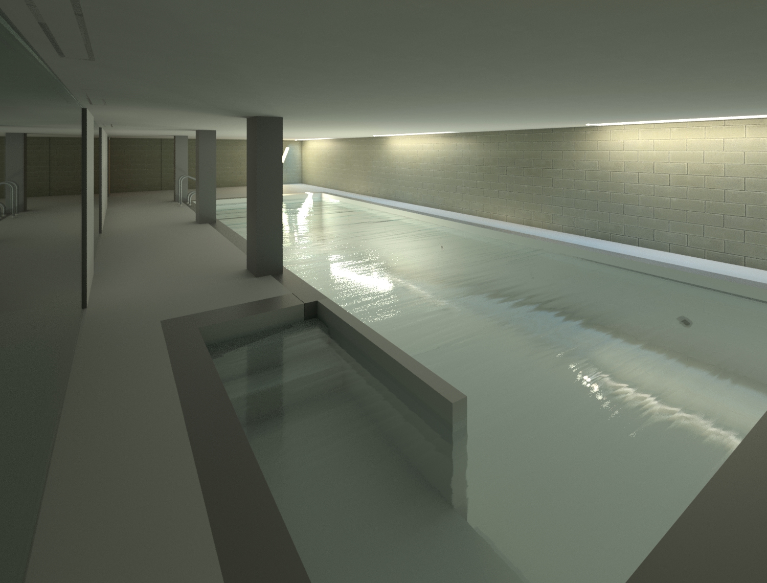

You can crete realistic looking water by creating a floor with one layer and giving it the 'site - water' material that ships with Revit.
See the first thread listed at the bottom listed water trick for further discussion on this.

I made using the same methord which is eiher floor or ceiling both will work. take your time to use defferent methords. it will work, change the volume of waves and try
