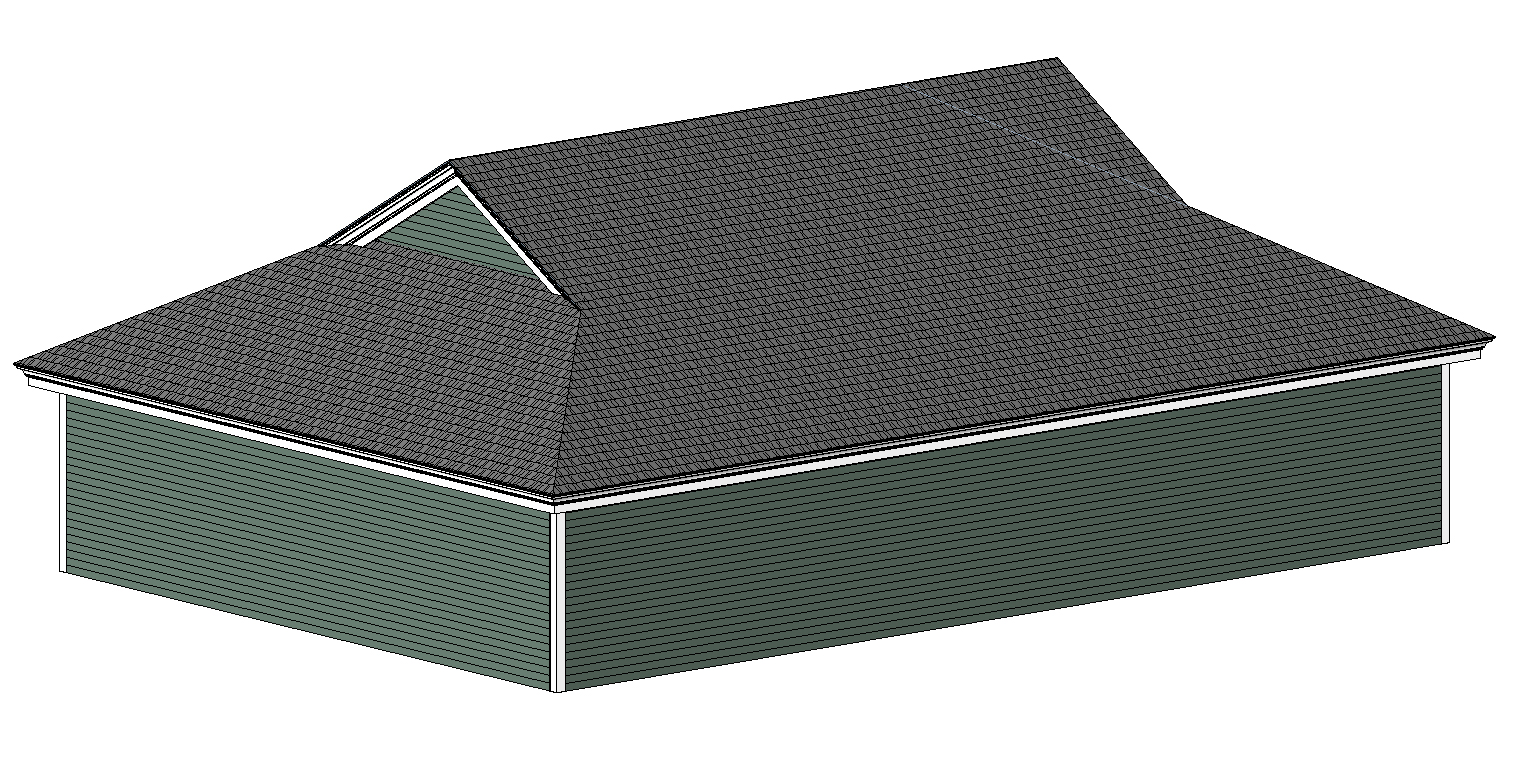

I would say that whatever software you choose, you eventually will run into something that you will have to do a workaround. Personally I feel Revit has what it takes to go far. There's alot of positives to it. They have a huge backing in the industry just from the fact that it's an Autodesk product. It's not entirely compatible with the dwg format, but I think it's getting there. As for your bad experience with the demo, I can't understand what went wrong there. It could be a difference between residential and commercial. I personally design residential and don't have a clue as to what needs to be done for commercial. He might not have known what a dutch gable is. I test drew one to see how long it would take with fascia, soffits, cornerboards, roofing etc, blah blah blah and it took MAYBE 5 minutes. It will take you awhile to get set up comfortably with your family files, your profiles, etc. but Revit is a good program. ArchiCAD is too from my understanding. I think there might be a couple ex ArchiCAD guys here. I'm an ex-SoftPlan person myself.

Thanks framerman Your comments much appreciated. Will download your file and have a look with grat interest. You have put my mind a bit more at ease. 5 minutes is very encouraging. Annoying part of demo is that you would expect someone 'experienced' to display a product - really colours what one thinks... Thanks again ---------------------------------------------------------------- PS Can different roof styles be set up in some sort of a template type of file - called up as required - adjusted as needed ?

To: framerman and aq10p. Pardon my interruption, but in Florida, your attached image is called a 'Boston Hip'. All four sides of your roof have the same SLOPE and the ridge is extended along the narrower sides creating a gable. In a DUTCH GABLE, as well as in the Florida Cracker Roof Style, you would have a change in SLOPE (similar to a barn bldg in Pennsylvania Dutch country). The Dutch roof slope would start at the bearing wall at a high (16/12) pitch, and then change to a shallow pitch (3/12) up to the center ridge line. The Style allowed for more space in the Hay Loft. In the Florida Cracker Home the slopes are just opposite of the Dutch barn. A low slope roof over the front and back porches and higher slopes over the interior living area.
I've just started using Revit so I have not attempted these roof styles, BUT I will need to be able to make these. In Architectural Desktop I've had to use roof slabs to simulate roof breaks. Then I had to CLEAN-UP the elevations and sections after. Not efficient.

to jahern: my apologies. i don't have any architectural schooling. i'm just a framer. someone along the way said "that's a dutch gable" so i've always named it that. the roof you're describing is what I call a gambrel roof. the other one, wow, don't know, but I have seen it. I've never heard of melanesian, I even googled it.

Just to back up framerman I have always known those roofs to be a gamberl style as well.  Look @ attached file.
